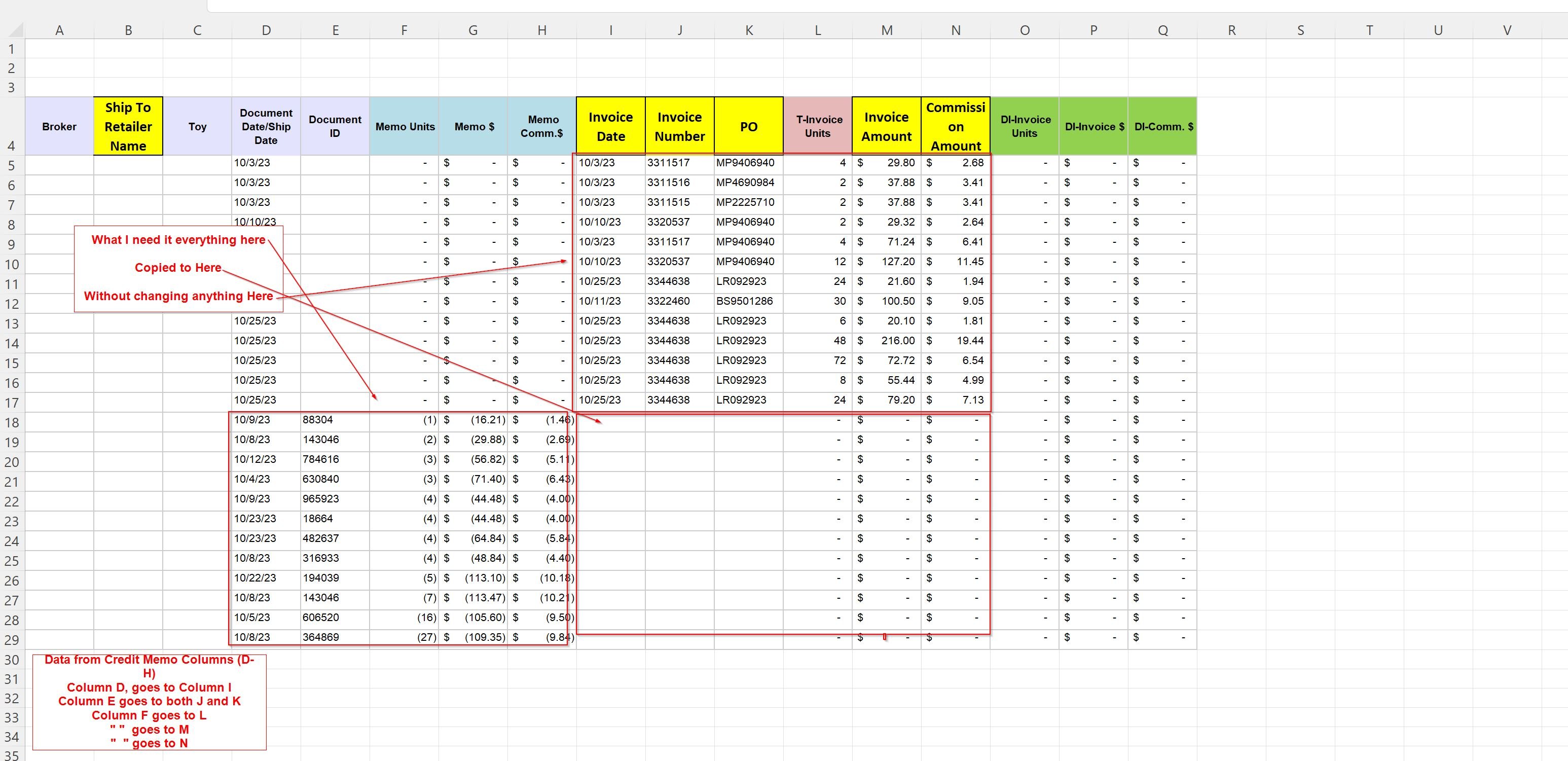

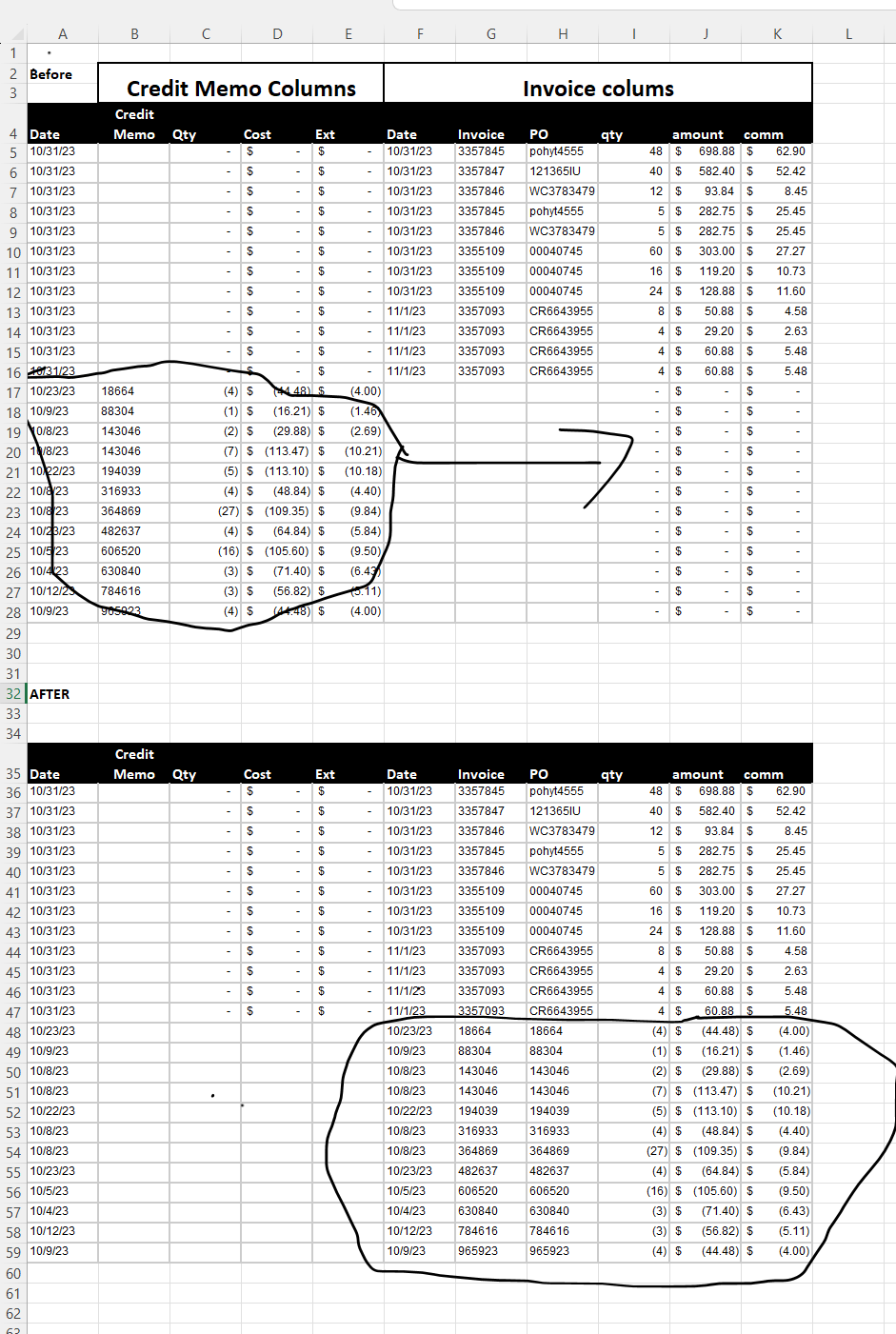

I have this sheet that a vendor sends me with commissions and credit memos. They put the commissions in one set of columns, and the credit memos in another set of columns.. I need to format the sheet so it can be imported into the sales system I use. Can anyone out there help me with some VBA code to go through this sheet and if there is data in the credit memo columns, just move it to the invoice columns?
Below is s a simple sample...but the sheet has 1000's of rows
Any help would be greatly appreciated.

    2023-12-22T23:00:28+00:00
    Thank you for your reply...this moves the data, but I only want the rows with data in the Credit Memo Columns to be affected. This macro basically removes every above row 17. I only want to move the data in the tows that have data in the credit memo columns....I dont want to remove the data in the columns above that have data in the Invoice columns. If you look at the image before and after, you see I need all of the data above row 17 to remain. When I run this, everything above row 17...is changed to zero. The sample file I gave you was not 100% accurate as far as the columns go...
    Here is a new version.
