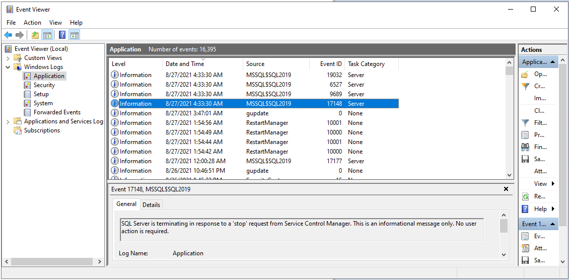

    what is the Event ID for SQL Server Stopped
    When SQL Serer stopped, There will be an information type Event ID 17148 (SQL Server is terminating in response to a 'stop' request from Service Control Manager. This is an informational message only. No user action is required.) in the application log and an information type Event ID 7036 (The SQL Server (instancename) service entered the stopped state.) in the system log.

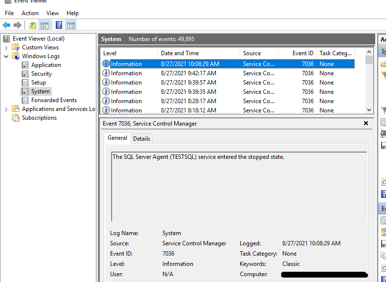

    what is the Event ID for SQL Agent Stopped.
    when SQL Server Agent stopped, there will be an information type Event ID 15457 (Configuration option 'Agent XPs' changed from 1 to 0. Run the RECONFIGURE statement to install.) and an information type Event ID 7036 (The SQL Server Agent(instancename) service entered the stopped state.) in the system log.

  1. Ronen Ariely 15,206 Reputation points
    2021-08-27T01:39:56.847+00:00
    Good day,
    (1) Open the SQL Server Configuration Manager
    (2) Open event viewer -> windows log -> application -> sort the information by date
    (3) Using the SQL Server Configuration Manager Stop the server
    (4) Check the events which were added in the event viewer
    Next do the same for the SQL Server Agent service
    Note! Stopping the SQL Server will stop related services and you will probably get a few events
