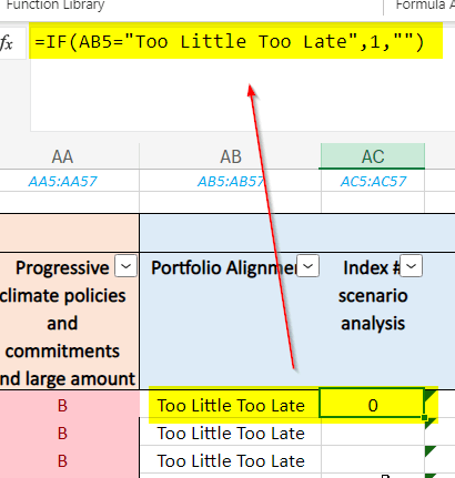

    Actually, whilst trying to replace the INDIRECT formulas, I found a good example of formulae not calculating (despite being automatic)
    I've attached an image of a cell where the logic clearly should return a 1, but it is zero instead. Very odd!
