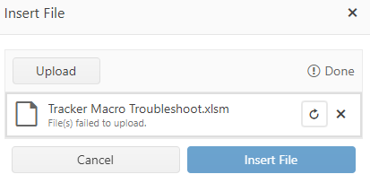

    2024-03-07T06:02:23+00:00
    Thank you - I just tried this and unfortunately the file failed to upload. Not having much luck with this!

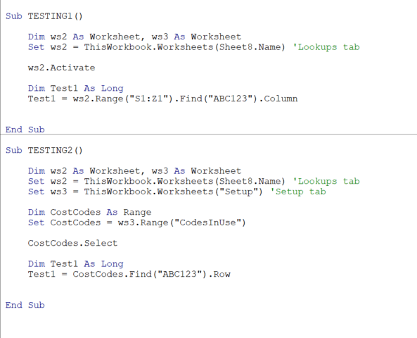

    To give a bit more detail, in the sample file I have the Setup tab, and the Lookups tab.
    Setup tab has a named range called CodesInUse, and the Lookups tab transposes this range in a spilled array formula (I posted an image of this before).
    When I reference the array formula in the lookup tab, I get the runtime error when I run the VBA code. If I replace the formula as values, the code runs fine. If I update the code to refence the actual named range in the Setup tab, the code works.
    As an aside, I also want to return the column number relative to the start of the range, not to the first column of the sheet. Is there a simple way to do this?
    TESTING1 generates runtime error, TESTING2 works.
