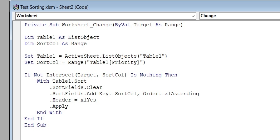

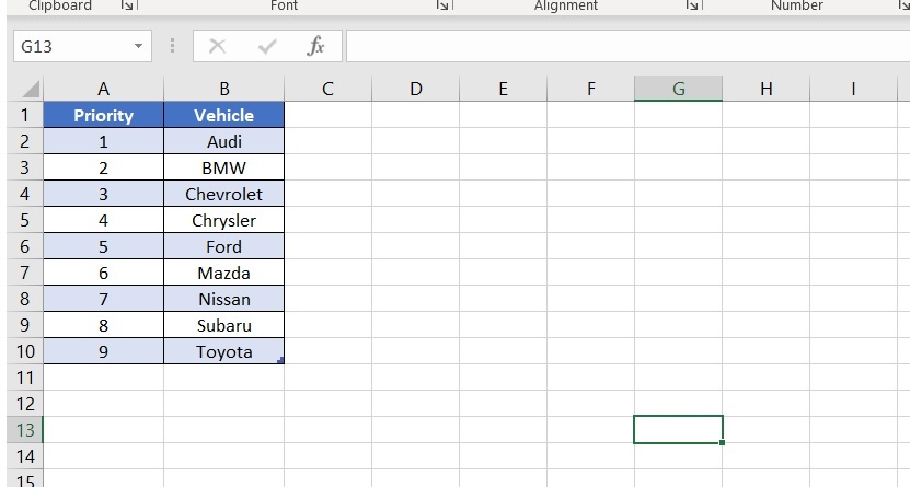

I am trying to create a VBA code to sort all columns based on the priority list. My priority list is an ascending column of numbers 1 through 50 in column A and column B is the list of priorities associated with the numbers. I need it to auto sort when a priority changes. For my test I have 1-9 in column A and a list of automotive companies in column B. If one of the companies changes in priority, I need it sorted to reflect the change. So if priority 5 changes to priority 1. I need it to re-sort it and then adjust everything down. I have a VBA code that re-sorts it when I change the priority number but haven't completed the code to adjust the numbers to reflect the change. Thank you.

    2024-03-06T14:47:41+00:00
    Private Sub Worksheet_Change(ByVal Target As Range)
    Dim tblT As ListObject
    Dim rngSortCol As Range
    Set tblT = Me.ListObjects("Table1")
    Set rngSortCol = Range("Table1[Priority]")
    If Intersect(Target, rngSortCol) Is Nothing Then Exit Sub
    'Turn off events to keep out of loops
    Application.EnableEvents = False
    With tblT.Sort
        .SortFields.Clear
        .SortFields.Add Key:=rngSortCol, Order:=xlAscending
        .Apply
    End With
    With rngSortCol
        .FormulaR1C1 = "=ROW()-" & tblT.HeaderRowRange.Row
        .Copy
        .PasteSpecial Paste:=xlPasteValues
        Application.CutCopyMode = False
    End With
    Target.Select
    'Turn events back on to get ready for the next change
    Application.EnableEvents = True
    End Sub

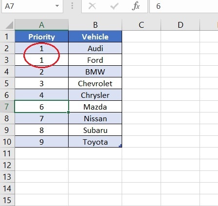

    2024-03-06T23:28:19+00:00
    Bernie,
    I greatly appreciate the help. It is close. When I change a priority it goes 1 number higher than what I want. Is there a adjustment that can be made to make it go to the right priority? For example, if I one to change a priority to priority 1, I have to change the current number to priority 0. Then it shifts everything down correctly. It works, but can I adjust something in the VBA code to make it go to the right priority? Thank you.
    2024-03-07T06:51:09+00:00
    =ROW()-1
    The above code has reset the priority according to the row index so unecessory to change current number.
    2024-03-07T14:34:56+00:00
    After this line:
    add the line
    Target.Value = Target.Value - 1
  5. Anonymous
    2024-03-07T14:42:31+00:00
    "ROW() - 1" only works if the table's data rows start in row 2. If the table is elsewhere, then the numbers don't start with 1.
