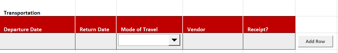

Hello,
I have a project where I want the user to press a button, and it would add a row below the current one with the same formatting, including a drop down menu.
So the desired result would be:
User clicks on an add row button with OKCancel message.
The current row they are in would then be duplicated below, including the Add Row button and a drop down menu (if included in current row)
Any help would be greatly appreciated.
Thanks
Right now my script is:
Sub AddRow()MsgBox ("Select a cell in the row you want to add") If Result = vbYes Then Else End If ActiveCell.Offset(1).EntireRow.Insert Shift:=xlDown, CopyOrigin:=xlFormatFromRightOrAbove ActiveCell.EntireRow.Copy ActiveCell.Offset(1).EntireRow.PasteSpecial xlPasteFormats Application.CutCopyMode = False End Sub

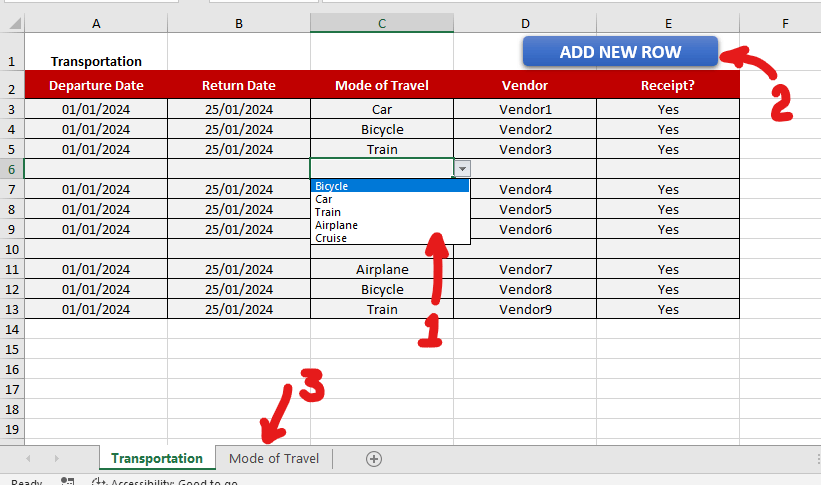

    Hi Amy
    To solve your problem I took a different approach

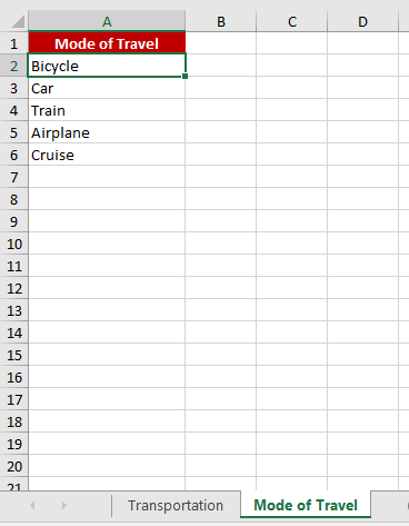

    1. I chose to make the dropdown list with the Data Validation figure rather than the dropdown from the Active X Controls.
    2. I also chose to insert a Shape instead of an Active X button. Only one shape as I don't see the need to copy/add a button on each row.
    3. The Model of Travel tab has the list for the dropdown
    3)
    Here is the working code
    Sub AddRow()
    Dim Answer As VbMsgBoxResult
    '''' This will pop up a message for you to decide
    Answer = MsgBox("Are you sure you want to Add a Row", vbYesNo, "ATTENTION")
    If Answer = vbNo Then
        Exit Sub
    Else
    With ActiveCell
        .EntireRow.Copy
        .Offset(1).EntireRow.ClearContents
        .Offset(1).Select
    End With
    End If
    End Sub
    Here is the sample file for you to download https://we.tl/t-vuU4QGczHd
    I hope this helps you and gives a solution to your problem
    Do let me know if you need more help
    Regards
    Jeovany
