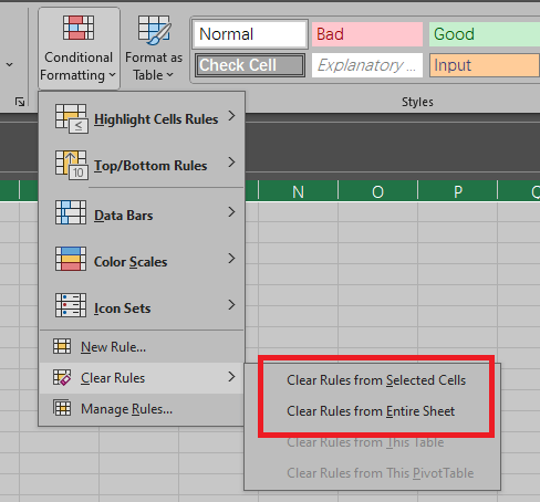

    2024-05-17T01:40:41+00:00
    You can use clear ruls for selected cells.
