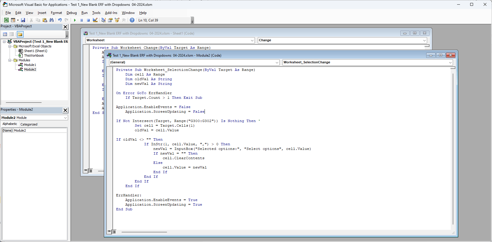

  3. HansV 462.6K Reputation points
    2024-05-17T07:00:53+00:00
    Procedures such as Worksheet_Change and Worksheet_SelectionChange are not ordinary macros. They are so-called event procedures.
    They should both be stored in the worksheet module, not in a standard module.
    So you can start by cutting the code from Module2 and pasting it into the module of Sheet1.
    But I suspect it won't do exactly what you want - let me know.
    2024-05-16T22:50:01+00:00
    HansV,
    Many thanks for your help. I started a new file with no VBA codes. I then copied the code you provided and it worked like a charm! However, I then copied a second code, which allows for multiple selections in the cell from the dropdowns within the sheet, but it's not working. It was working when I only had one VBA code. In the screenshot below you will see this code in the foreground. I selected the worksheet called "Sheet1 (Sheet1)" then I right clicked and selected INSERT then MODULE. Either I'm doing something wrong or the codes don't mix. Do you know what the issue could be? Thanks again!
