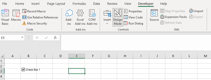

    Depending on what you actually want to do, it might not be necessary to use VBA.
    It is optional but the name of the CheckBox can be removed (Leave blank ).
    You can assign a linked cell to the CheckBox and then refer to the linked cell for the CheckBox selection (True or False).
    The Linked cell can be the one in which the CheckBox is created, or any other cell. If you don't want to see the True or False in the cell, just set the font color for the cell to the same as the cell fill color and then the value is actually in the cell, but it is invisible. It is not practical to use the linked cell for other values because an entered value overwrites the True/False or True/False overwrites any other value.
    To set the properties for the CheckBox:
    If it is an ActiveX CheckBox: Display the Developer ribbon and click the Design Icon and then Right click the CheckBox and select Properties.
    If it is a Forms Control: Right click the control and select Properties and then you can select the various tabs in the dialog for setting the properties.
