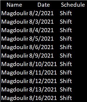

Hi guys,
I need your help please.
As you could see the below table screen shot got a column that has a list of dates, but it misses some days in the middle. I hope to build a query that add for me the missing days. The start and end dates in the desired series should be the oldest and the latest date in the existing column consecutively, how could I do that?
(Image #1)

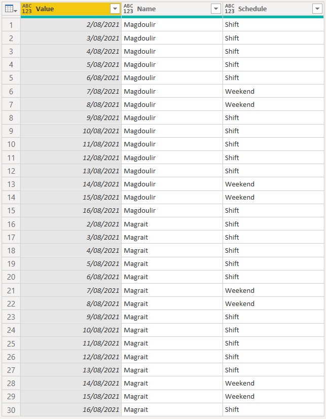

I applied this code that got me a part of the solution but created for me another problem
let
Source = Excel.CurrentWorkbook(){[Name="Table6"]}[Content],
#"Changed Type" = Table.TransformColumnTypes(Source,{<!-- -->{"Name", type text}, {"Date", type date}, {"Schedule", type text}}),
Dates = Table.FromColumns({List.Transform({Number.From( (Date.From(List.Min(#"Changed Type"[Date]))))..Number.From( (Date.From(List.Max(#"Changed Type"[Date]))))}, Date.From)}, {"Date"}),
Merged = Table.NestedJoin(Dates, {"Date"}, #"Changed Type", {"Date"}, "Gr", JoinKind.LeftOuter),
Expanded = Table.ExpandTableColumn(Merged, "Gr", {"Name", "Schedule"}, {"Name", "Schedule"}),
Reordered = Table.ReorderColumns(Expanded,{"Name", "Date", "Schedule"}),
#"Filled Down" = Table.FillDown(Reordered,{"Name"}),
#"Replaced Value" = Table.ReplaceValue(#"Filled Down",null,"Weekend",Replacer.ReplaceValue,{"Schedule"}),
#"Sorted Rows" = Table.Sort(#"Replaced Value",{<!-- -->{"Name", Order.Ascending}, {"Date", Order.Ascending}})
in
#"Sorted Rows"
And this got me the below output:
Image #2

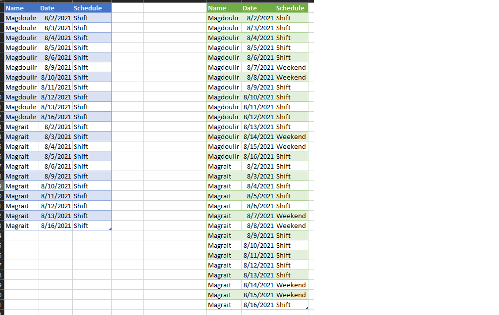

Now, problem is happening when there is more than 1 name in the data source table like the below:
Here we get undesirable output and the transformation is applied only in the latest name in the list but not on the rest of the names
Image #3

  2. Ron Rosenfeld 271 Reputation points
    2021-08-29T12:22:44.06+00:00
    Your algorithm is basically OK, except that, with multiple names, you can:
    • Group by Name
    • Create full date list for each Name
    • Join the sub tables
    • Do the housekeeping (sorting; replacing null with weekend, etc
    Creating the datelist for each Name, within the Group function, cannot be done within the UI, but must be done in the Advanced Editor.
    M Code
      let
            Source = Excel.CurrentWorkbook(){[Name="Table5"]}[Content],
        //Group by Name
        //Then create Table of dates for each subgroup
            #"Grouped Rows" = Table.Group(#"Changed Type", {"Name"}, {
                    {"All", each _, type table [Name=nullable text, Date=nullable date, Schedule=nullable text]},
                    {"All Dates", each Table.FromList(
                            List.Dates(List.Min([Date]),
                                Duration.TotalDays(List.Max([Date])-List.Min([Date]))+1,
                                #duration(1,0,0,0)),Splitter.SplitByNothing(),{"allDates"})}
        //Join the two tables with a RightOuter join,
        //Then "fill down" the missing names in the Name column
            #"Added Custom" = Table.AddColumn(#"Grouped Rows", "mergedDates",
                each Table.FillDown(
                    Table.Join([All],"Date",[All Dates],"allDates",JoinKind.RightOuter),{"Name"})),
        //Housekeeping
            #"Removed Columns" = Table.RemoveColumns(#"Added Custom",{"Name", "All", "All Dates"}),
            #"Expanded mergedDates" = Table.ExpandTableColumn(#"Removed Columns", "mergedDates",
                {"Name", "Schedule", "allDates"}, {"Name", "Schedule", "allDates"}),
            #"Changed Type1" = Table.TransformColumnTypes(#"Expanded mergedDates",{
                {"allDates", type date}, {"Name", type text}, {"Schedule", type text}}),
            #"Renamed Columns" = Table.RenameColumns(#"Changed Type1",{<!-- -->{"allDates", "Date"}}),
            #"Sorted Rows" = Table.Sort(#"Renamed Columns",{<!-- -->{"Name", Order.Ascending}, {"Date", Order.Ascending}}),
            #"Reordered Columns" = Table.ReorderColumns(#"Sorted Rows",{"Name", "Date", "Schedule"}),
            #"Replaced Value" = Table.ReplaceValue(#"Reordered Columns",null,"Weekend",Replacer.ReplaceValue,{"Schedule"})
        in
            #"Replaced Value"

    thank you all for your help, I'm quite sure your solutions work, it's just I got the needed support from another forum earlier and the code worked for me which is (for the reference):
    let
    Source = Table.FromRows(Json.Document(Binary.Decompress(Binary.FromText("i45W8k1MT8kvzcnMU9JRstA30jcyMDIEMoMzMtNKlGJ10BUYE1JgQkiBKSEFZoQUWBJSYGhAUIUhQRUEg8KQYFgYYvFKREVFBVDAHFtQw+WwmAyXwxLAcDkMj8cCAA==", BinaryEncoding.Base64), Compression.Deflate)), let _t = ((type nullable text) meta [Serialized.Text = true]) in type table [Name = _t, Date = _t, Schedule = _t]),
    DateType = Table.TransformColumnTypes(Source,{{"Date", type date}}),
    Grouped = Table.Group(DateType, {"Name"}, {{"Date", each List.Transform({Number.From( (Date.From(List.Min([Date]))))..Number.From( (Date.From(List.Max([Date]))))}, Date.From) }}),
    "Expanded Gr" = Table.ExpandListColumn(Grouped, "Date"),
    "ChangedType" = Table.TransformColumnTypes(#"Expanded Gr",{{"Date", type date}}),
    "FINAL" = Table.AddColumn(ChangedType, "Schedule", each if Date.DayOfWeek([Date],Day.Monday) >4 then "Weekend" else "Shift")// or do a merge with Source table if you have some other condition
    in
    "FINAL"
