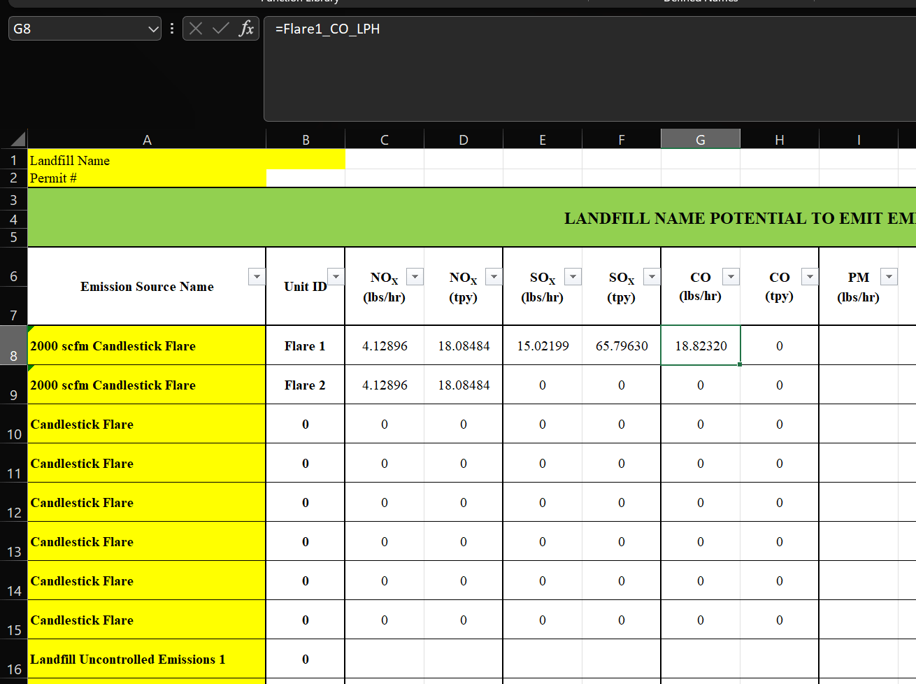

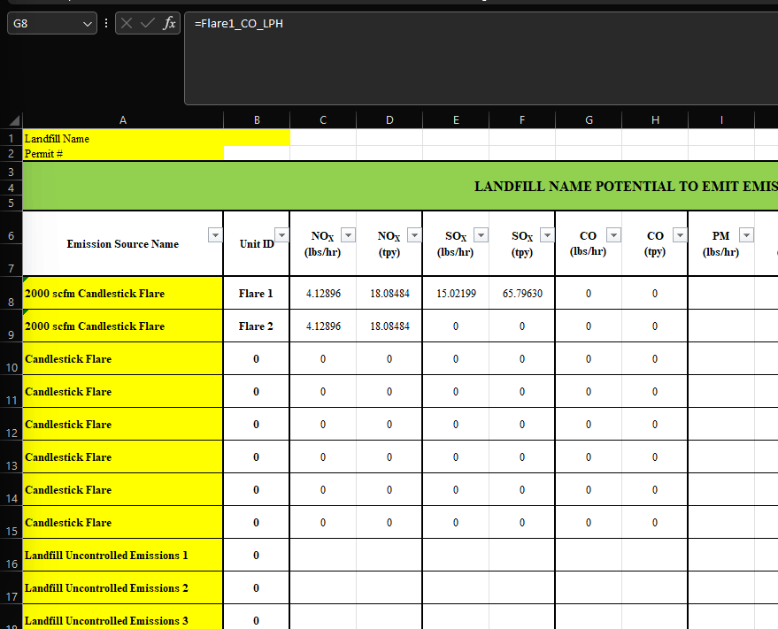

A) I have Cell G8 in tab "Total Site Emissions" set to the formula "=Flare1_CO_LPH", a name manager name. The Cell is displaying a value of 0.
(All the values that are a value of 0 on this sheet are not 0 on the cells that they are linked to. Cells C8, C9, D8, D9, E8, and E9 had the same problem, but I had clicked into them and "recalculated" them as stated in Step D)

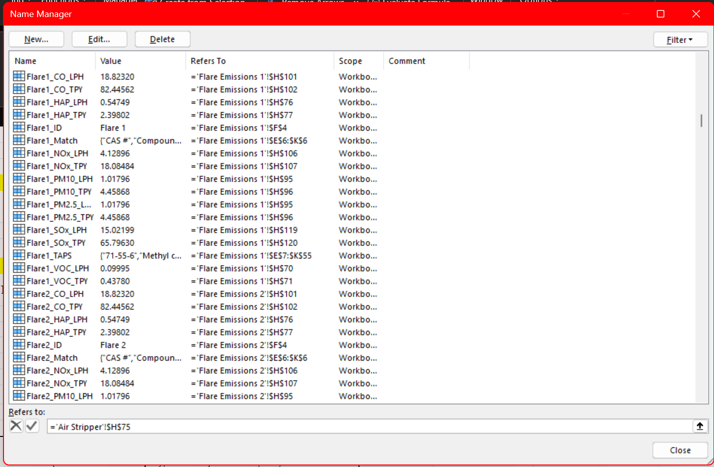

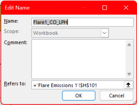

B) Within the Name manager, it is displaying "18.82320" within the "Value" column. The formula the Name manager has for "Flare1_CO_LPH" is "='Flare Emissions 1'!$H$101"

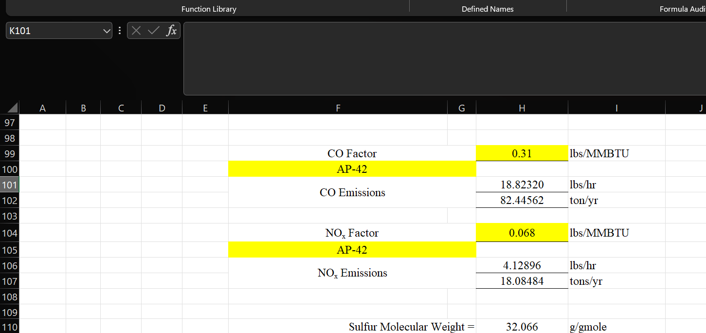

C) When I go to "'Flare Emissions 1'!$H$101" in the "Flare Emissions 1" tab, the value is indeed 18.82320.
D) When I go into Cell G8 in "Total Site Emissions" tab and pretend as if I am editing the cell, and click enter to confirm my equation, the value updates from 0 to 18.82320 without making any changes to the current formula in the cell, just reconfirming what I already had in there.
