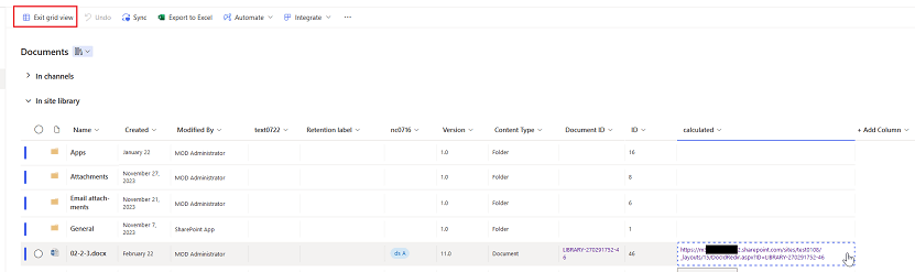

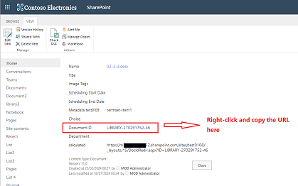

    As you mentioned, we need to go to the details pane of the item(file) to copy the URL with the Document ID from the Document ID column/field. Also, based on my test, another way is to copy the URL from the Properties view of the item(file) via the three dots> More> Properties.
    If you want to copy the URL with the Document ID without going to the details pane, as a workaround, you can use a Calculated column and JSON code to build the URL with the Document ID and make it clickable in the library view. However, in this case, you need to click "Edit in grid view", and then copy (Ctrl + C) the URL from the cell/field.
