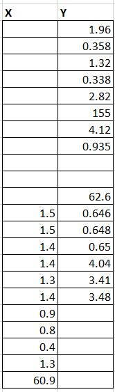

Without much more introduction. Here below a small illustration of the situation:

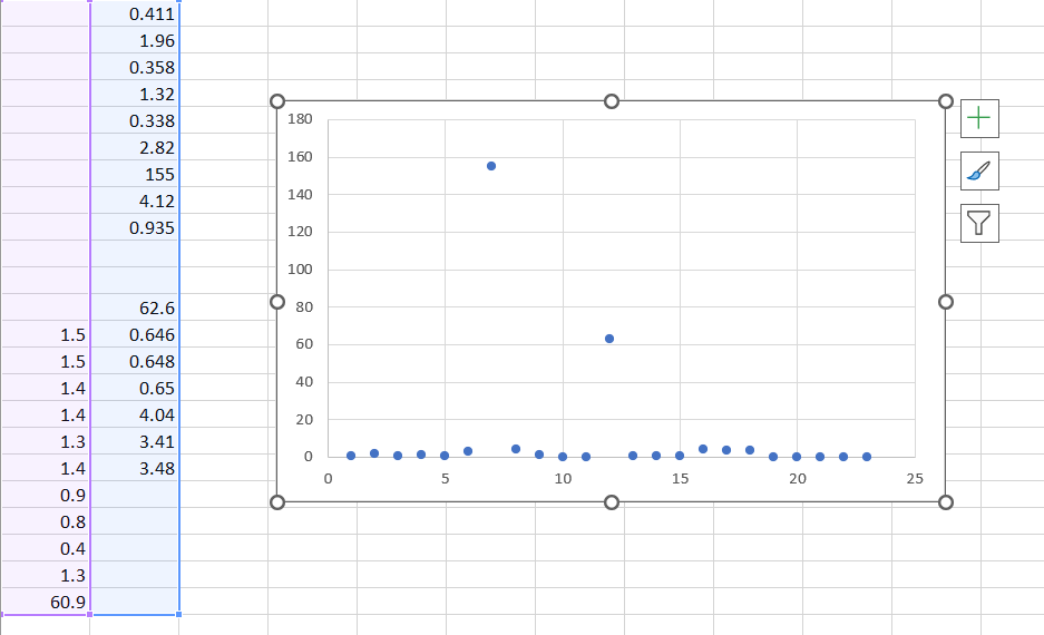

When I create a scatterplot from the previous table I get :
... and you can quickly realize that there is something wrong. It is kind of putting in the X-axis the row number instead of my real X-axis according to the table and there are also some weird points in the Y-axis.
what I am looking to obtain is this result:
which is the result I would obtain If I delete incomplete lines, but yet again, that won't be an option for me.

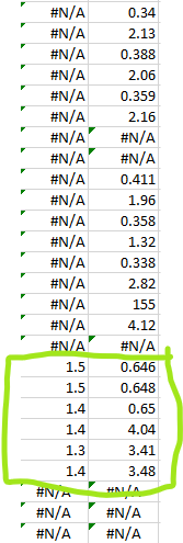

    Thank you for your reply. Unfortunately, I cannot provide acces to this dataset. However, I found a workaround:
    Instead of using IFERROR(B2,""), I used IFERROR(B2,#N/A). In this way, when doing the scatter plot, it takes into account only the rows where I have both X and Y (like in the image below).

    I think I have identify where the problem comes from. In reality I have a formula in my columns:
    and this column E despite is "empty", is not really empty. I created another columns to verify with ISBLANK. and it shows me the "empty" cells are not actually empty
    This is what seems to be creating the problems when I create the scatterplot.
    Do you know how to force and empty cell with my formula IFERROR ?
    Thanks.

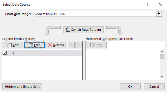

  5. Anonymous
    2024-04-12T15:02:22+00:00

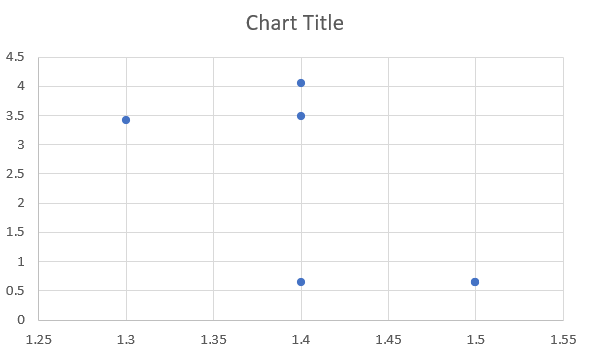

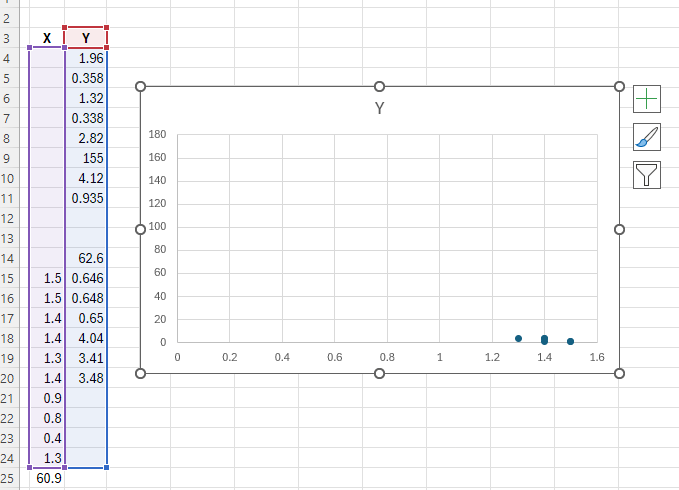

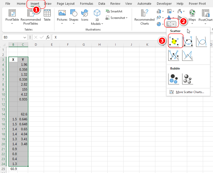

    This is what I get when I select the data and choose as shown:
    which results in:

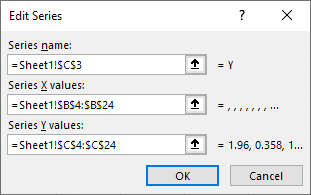

    This is what shows when I select data and edit series (NO EDITING WAS DONE or NEEDED):
    All I then needed to do was to adjust the max/min for each axis to get:
    The data on the sheet was not touched/edited at all.
