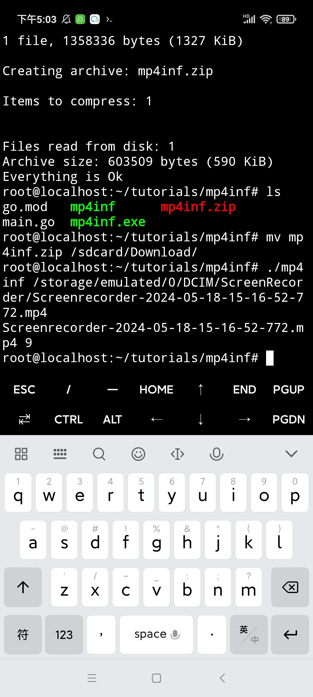

    Download console tool:
    https://filetransfer.io/data-package/lsmAOGs6#link
    command line:
    d:\mp4inf.exe yourMp4.mp4
    will return the length in seconds.

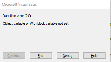

    I replaced my old function with yours. Things were looking up until I got the line:
     Set sFile = oDir.ParseName(strFile)
    where I got this message:
    The value of strFile is "c130 drop.MP4".
    Because I've had issues with spaces in folder/file names before I changed it to remove the space but got the same error.
    2024-06-03T22:18:32+00:00
    I'm not familiar with the tool. Can it also retrieve other file attributes like size (in bytes), date created, etc?
    Thanks.
  5. Anonymous
    2024-06-03T22:35:24+00:00
    No,only play time in seconds.
    I compiled it from below.
    https://www.cnblogs.com/Akkuman/p/12371838.html
