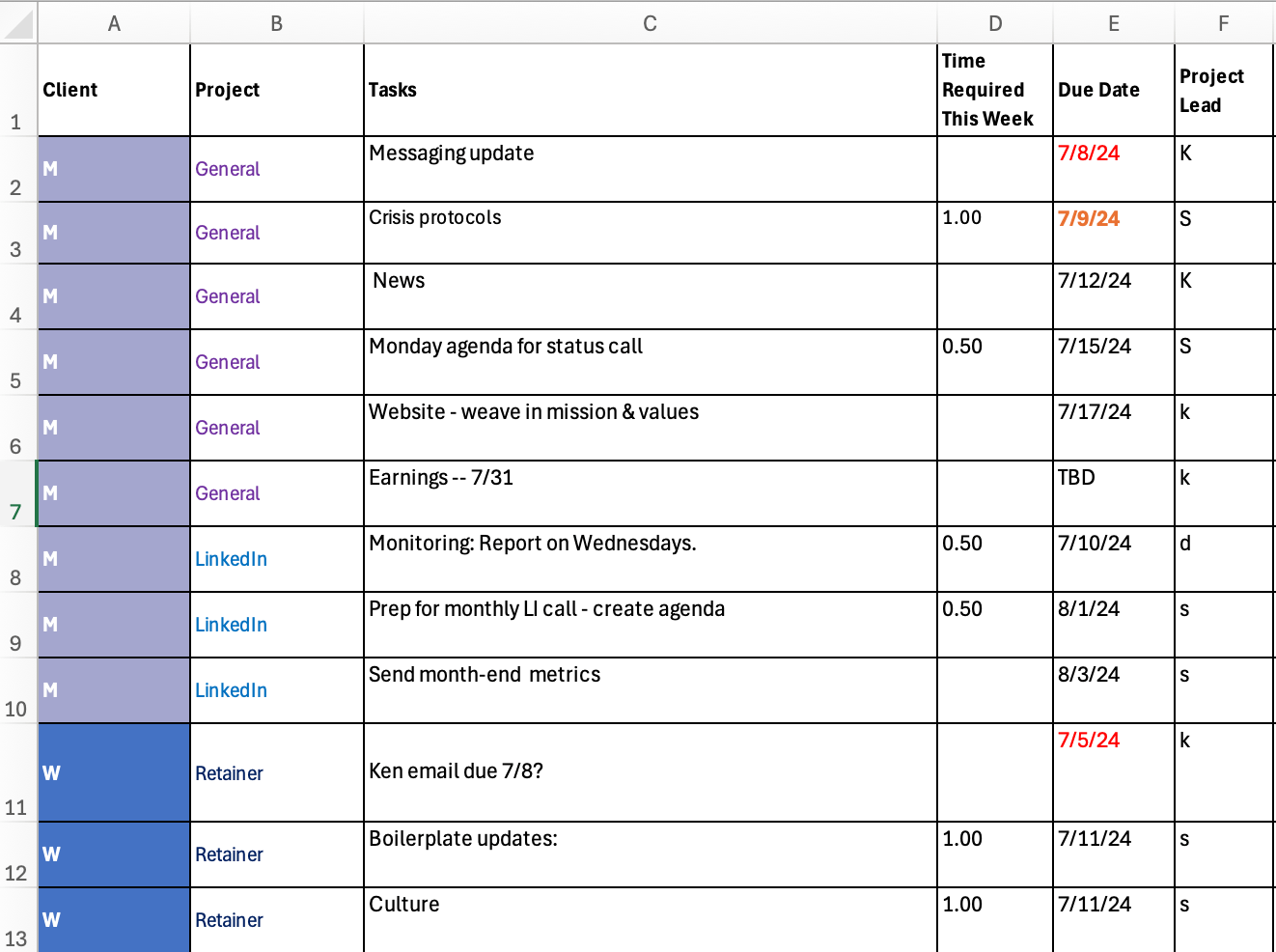

I tried reinstalling the macro, and it still doesn't work in my file.
Susanna,
your dates are in column D, not in column E as you shown above!
Change the line
Area.Sort Range("E1"), xlAscending, Header:=xlNo
to
Area.Sort Range("D1"), xlAscending, Header:=xlNo
done.
Andreas.

    2024-07-10T20:10:51+00:00
    Thanks - still not working.
    It is sorting one selected range thusly -- putting 7/15 first:
    7/15/24
    7/15/24
    7/9/24
    7/8/24
    7/12/24
    7/17/24
    7/12/24
    7/31/24
    TBD
    I put a test range lower down and tried, but got the message "Select some cells inside the data. Aborted"

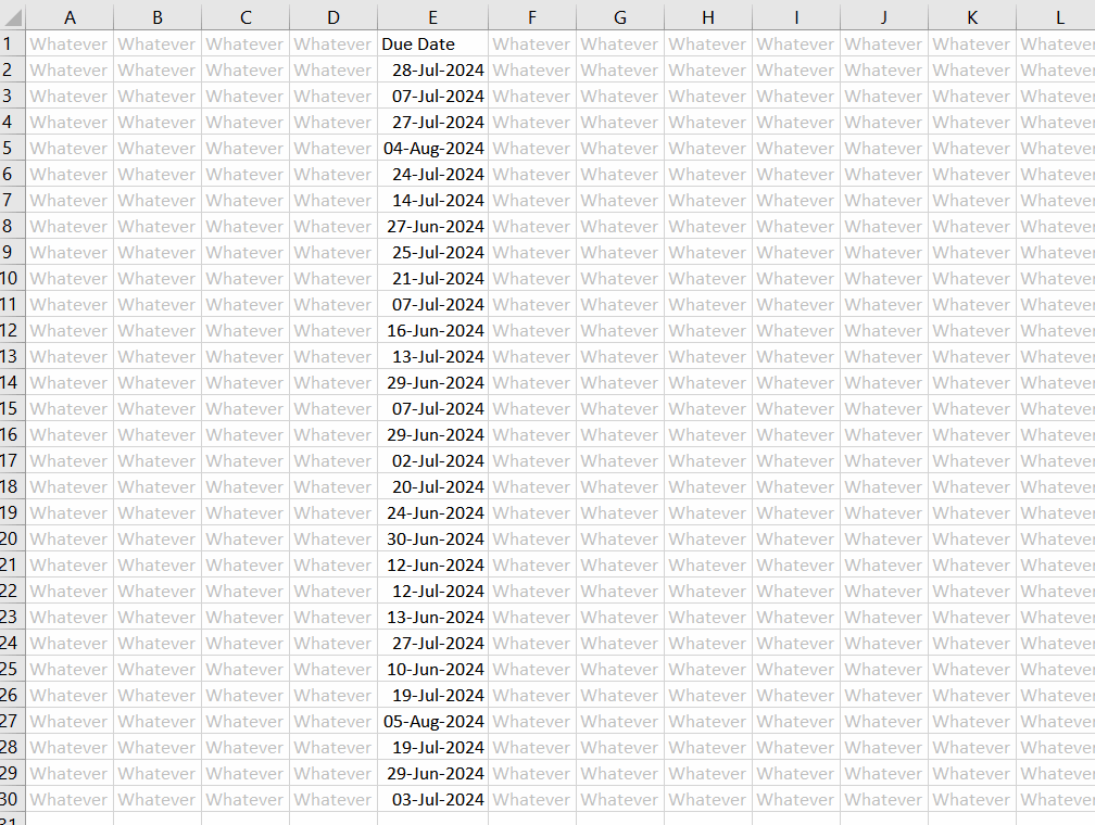

    Right-click on the sheet tab
    Choose "View Code"
    Within the menu click Insert \ Module
    Paste in the code below
    Close the VBA editor
    Press Alt-F8
    Choose the macro
    Click Run
    As shown, you can select one or multiple areas as you like.
    Andreas.

    2024-07-09T20:43:54+00:00
    Hmm, I don't quite understand your example.
    My spreadsheet lists client (column A), project (column B), task (column c) -- and column E is due date. Screenshot below in case that helps.
    I want to sort within each client/project by due date, earliest date first.
    So I might select rows 2-8, and I want to hit the macro shortcut to sort those rows by due date (column E).
    Then I want to be able to select rows 13-25 (different client/project) and use the macro to sort those rows by due date (column E).
    I created the macro by "Record Macro," and it has recorded only for the specific rows I was using at that time. I want the macro to complete the action (sorting) but be agnostic to the rows -- so that it will complete the action on the rows I have selected when I run the macro.
    Thank you!
