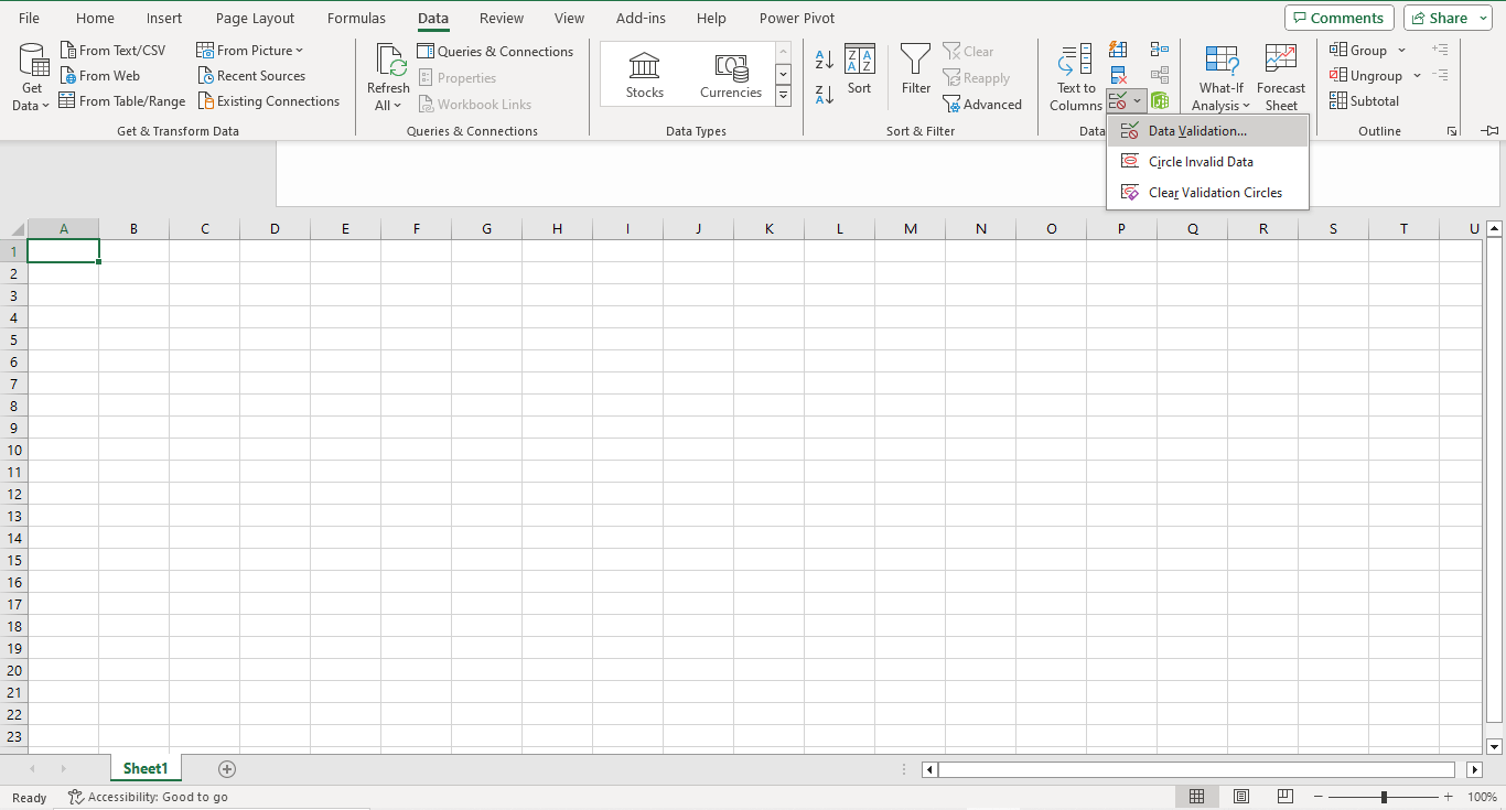

    Thanks for the reply.
    Correct me if I’m wrong but this is for a spreadsheet before data entry?
    Unfortunately this is data that usually is already entered so I don’t think that will apply here? I need to change the entries after they’ve been entered to the correct format eg 17:30 from 17.30.
