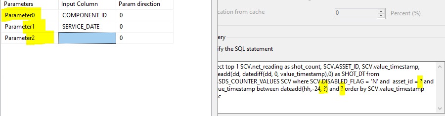

Hello Team - How do I replace the below parameter with the logic?
below is the current logic
where [value_timestamp] >= dateadd(dd,-1, service_date)
I want to replace the where clause for valuetimestamp like below :
where [value_timestamp] between dateadd(hh,-24, service_date) and service_date
Does this work ?
where [value_timestamp] between dateadd(hh,-24, ?) and ? -- But do i need to create another parameter for this ( parameter 2 for teh SERVICE_DATE ?
Thank you

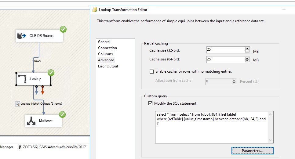

    Hi @kkran .
    It should be work with where [value_timestamp] between dateadd(hh,-24, ?) and ?.
    Below is my simple test that I have not created another parameter and the task works.
    An example you may also take a reference: partial-cache-lookup-with-a-date-range
