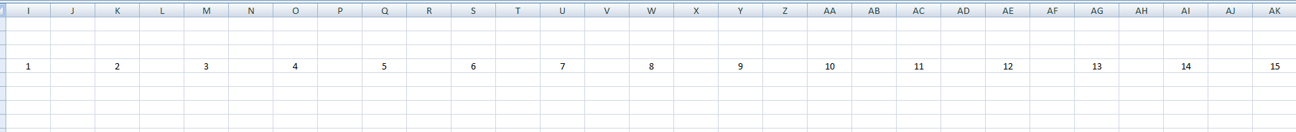

VBA code to insert an empty column from coolumn I to column HL when the numbering changes in cell $I$4:$H$L4
2024-05-22T22:17:45+00:00
Dear Sir / Madam,
Is there any VBA codes to run in order to execute this task?
Thanks in advance.
