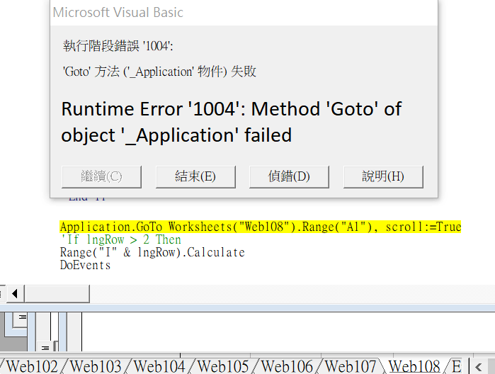

Error '1004': Method 'Goto' of object '_Application' failed
2024-05-01T23:44:49+00:00
Referring to following image, "Web108" is existed, but why do I still get following error?
Based on experience, it used to run without any problem, but this error only occur within this week.
Any suggestions?
Thanks in advance for any suggestions :)

    Is that worksheet protected?
    2024-05-02T11:45:22+00:00
    Once I stop macro, and check excel worksheet, it seems freeze, and not able to do anything.
    Any coding can check on what is going wrong?
    Any suggestions?
    Thank you
    2024-05-02T14:49:20+00:00
    It implies that the sheet could be protected.
    On the other hand, it could be that Application.ScreenUpdating being False is still in force if you have stopped the macro.
    Try typing:
    Application.Screenupdating=True
    into the Immediate pane and press Enter.
    That might free up the apparent freeze.
    I can't think of any code to apply to diagnose this. Would need to see the workbok.
