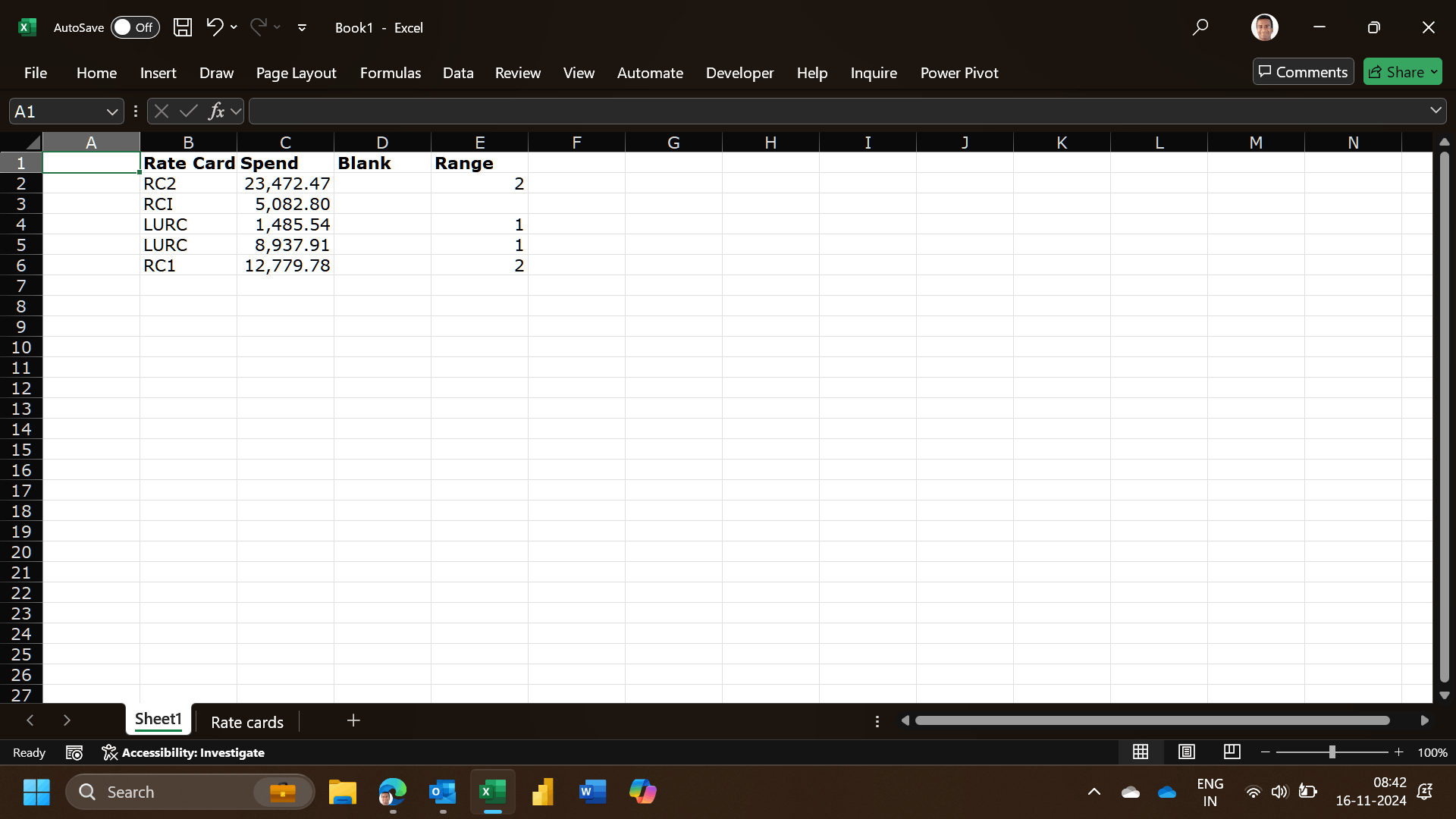

I am trying to build a formula that is essentially a vlookup on two criteria. The issue is the second criteria where the rate will be "equal to or greater than"
Sheet 1: Formula is in Column E
B C D E
1 Rate Card Spend Blank Range
2 RC2 23,472.47 #N/A
3 RCI 5,082.80 #N/A
4 LURC 1,485.54 #N/A
5 LURC 8,937.91 3
6 RC1 12,779.78 #N/A
attempted Formula in E:
=IF(C3=0,"",VLOOKUP(B3&"|"&IFERROR(VLOOKUP(ROUND(C3,2),'Rate Cards'!E:E,1,TRUE),C3),'Rate Cards'!B:G,6,FALSE))
I Understand why this isn't working.
Additional desired result in Range.C3 is less than the minimum in E2, so we want a blank "" result.

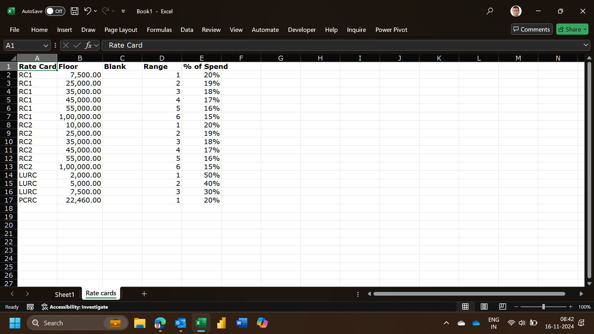

Sheet 2: Ranges - using the Helper in Column A =D2&"|"&E2
A D E F G H
1 Month Range Helper Rate Card Floor Blank Range % of Spend
2 RC1 7500 RC1 7,500.00 1 20%
3 RC1 25000 RC1 25,000.00 2 19%
4 RC1 35000 RC1 35,000.00 3 18%
5 RC1 45000 RC1 45,000.00 4 17%
6 RC1 55000 RC1 55,000.00 5 16%
7 RC1 100000 RC1 100,000.00 6 15%
8 RC2 10000 RC2 10,000.00 1 20%
9 RC2 25000 RC2 25,000.00 2 19%
10 RC2 35000 RC2 35,000.00 3 18%
11 RC2 45000 RC2 45,000.00 4 17%
12 RC2 55000 RC2 55,000.00 5 16%
13 RC2 100000 RC2 100,000.00 6 15%
14 LURC 2000 LURC 2,000.00 1 50%
15 LURC 5000 LURC 5,000.00 2 40%
16 LURC 7500 LURC 7,500.00 3 30%
17 PCRC 22460 PCRC 22,460.00 1 20%

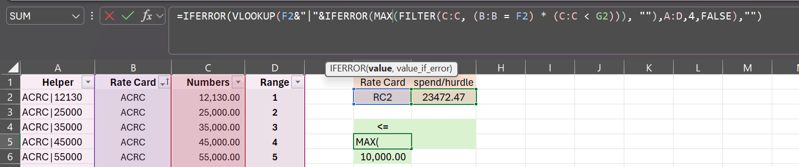

    I have solved the issue.
    The final formula is as follows:

    2024-11-18T17:37:13+00:00
    Ashish,
    This is getting us closer, but the formula is not pulling the correct ranges.
    See how your Range for RC2 is pulling Range 2? The 23,472 spend is less than the floor of 25,000.00 in Range 2. The formula should be pulling Range 1 for this result.
    Additionally, if a range does not meet the minimum criteria on the rate card (greater than or equal to the floor), the result should pull a blank""
  5. Ashish Mathur 102K Reputation points Volunteer Moderator
    2024-11-16T03:12:53+00:00
    In cell E2, enter this formula
    =XLOOKUP(B2&C2,'Rate cards'!$A$2:$A$17&'Rate cards'!$B$2:$B$17,'Rate cards'!$D$2:$D$17,"",1)
    Rate card sheet is
