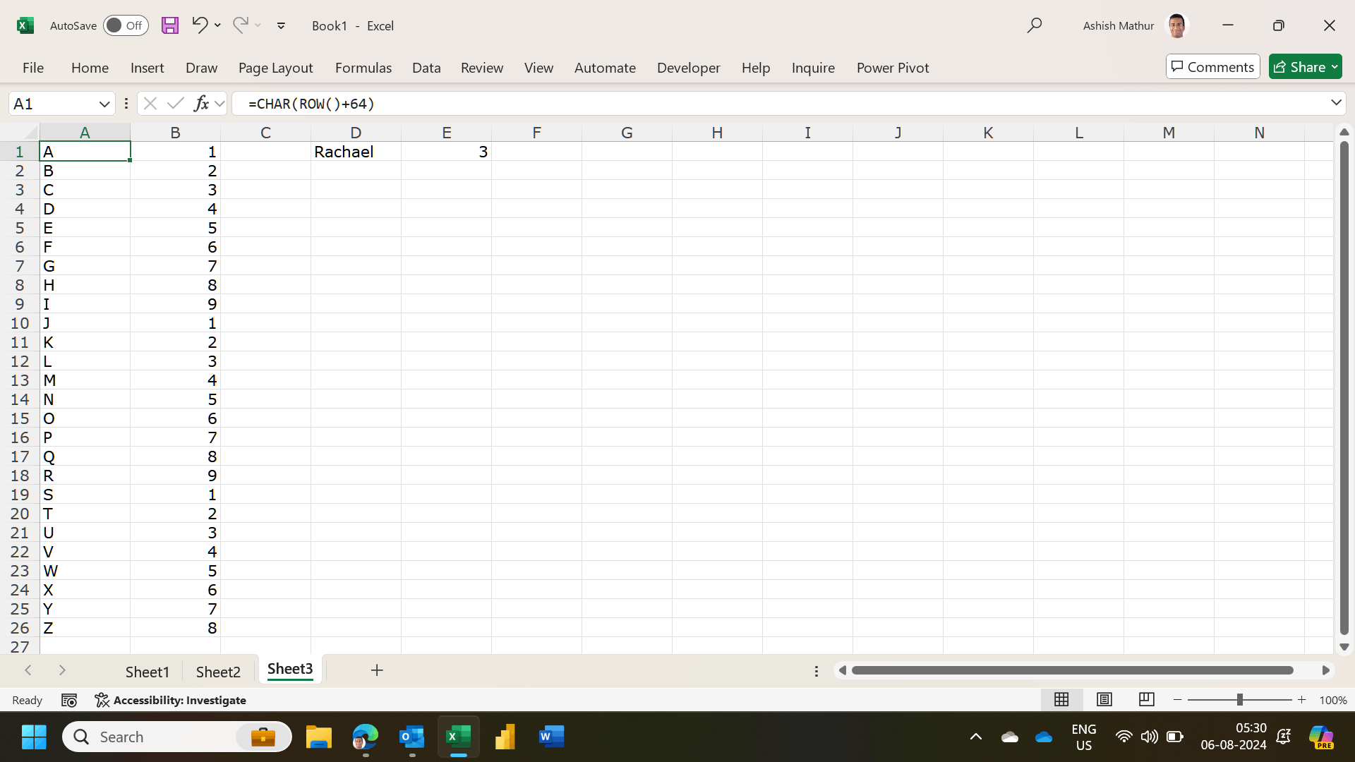

In cell E1, enter this formula
=MOD(SUM(XLOOKUP(MID(D1,SEQUENCE(LEN(D1)),1),A1:A26,B1:B26))-1,9)+1
Hope this helps.

    2024-08-06T05:50:28+00:00
    Anish, this formula does exactly what I need.
    Thank you so very much for taking time to respond.
