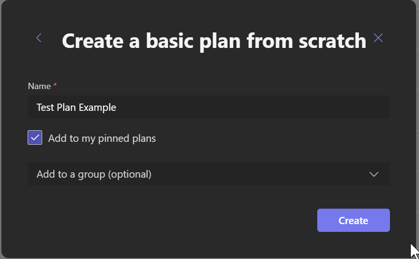

    I started a Private Plan in Teams Planner. (If I start the plan in Planner Web, I'm required to enter a group)
    There I can create a plan and do not have to add a group. Note Optional

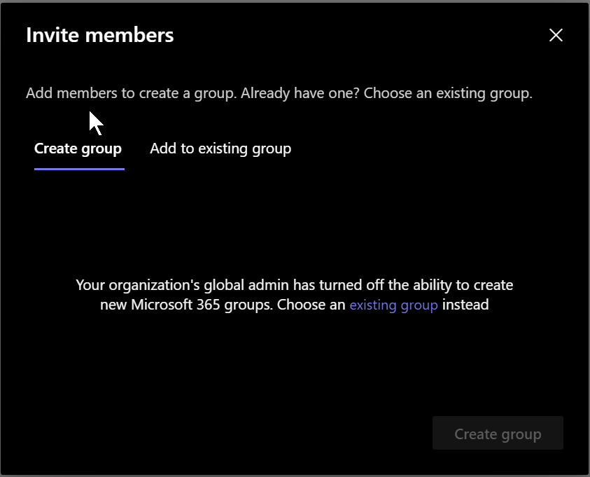

    Once I create the Plan, If I click on the Invite members in the top right, I am prompted to create a group or add to existing group.
    I'm not currently able to create a group at my organization but this plan will only be shared with a single person.

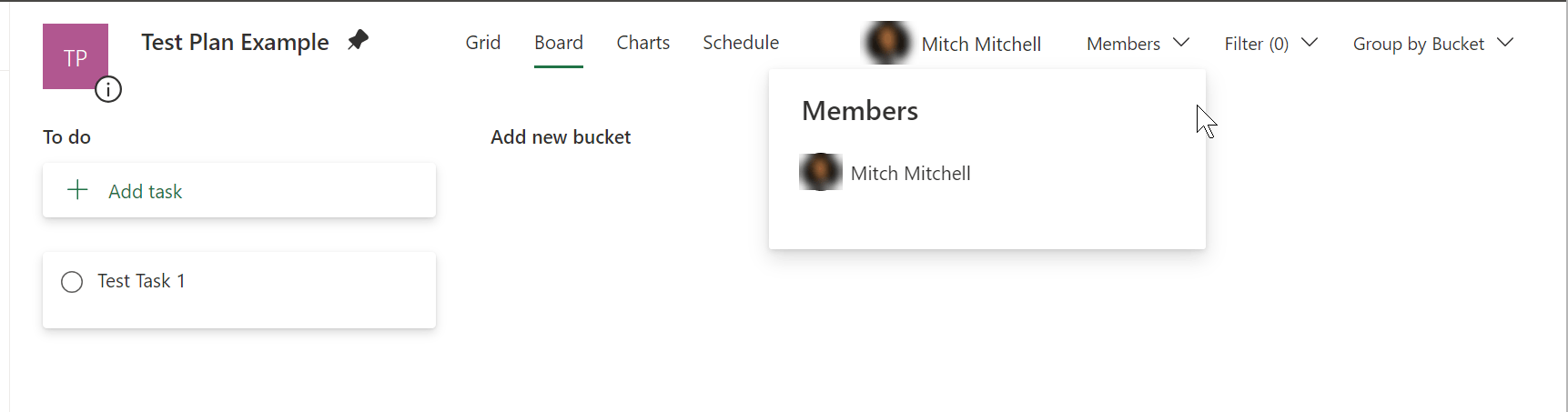

    In Planner Web, on the same Private Plan, I do not have the option to add members.

    Honestly, the root cause is, your organization admin diable a create an Office 365 group that why you cannot add a member one by one.
    In private planner only an owner/creator can see the plan but cannot share(no have ability to share) when your organization admin allows you to create an Office 365 group, then can add members one by one.
