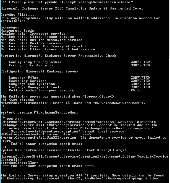

I completed the ADprep and started the update to CU21
Everything seem to be going fine but then I started getting errors
The process fails while step:
Mailbox role: Transport
Microsoft ExchangeServiceHost will not start.
Unable to start most of the MsExchnage Services
Web UI does not start at all.
Also getting tons of Event ID 2280 errorw:
The Module DLL C:\Program Files\Microsoft\Exchange Server\V15\Bin\kerbauth.dll failed to load. The data is the error.

    The problem was fixed by copying the application files from the CU21 Source ISO to the common folder in the installation path on the server.
    It seems that during the update process not all files were copied. The Microsoft Exchange Active Directory Service could not start because it was trying to use the service file from the previous CU version.
    Once the correct files from CU21 was copied over all of the services were able to start and the update completed without any further problems.
    Once the update was complete a reboot was needed. After reboot I applied the latest security update for CU21 and then everything started working again.
