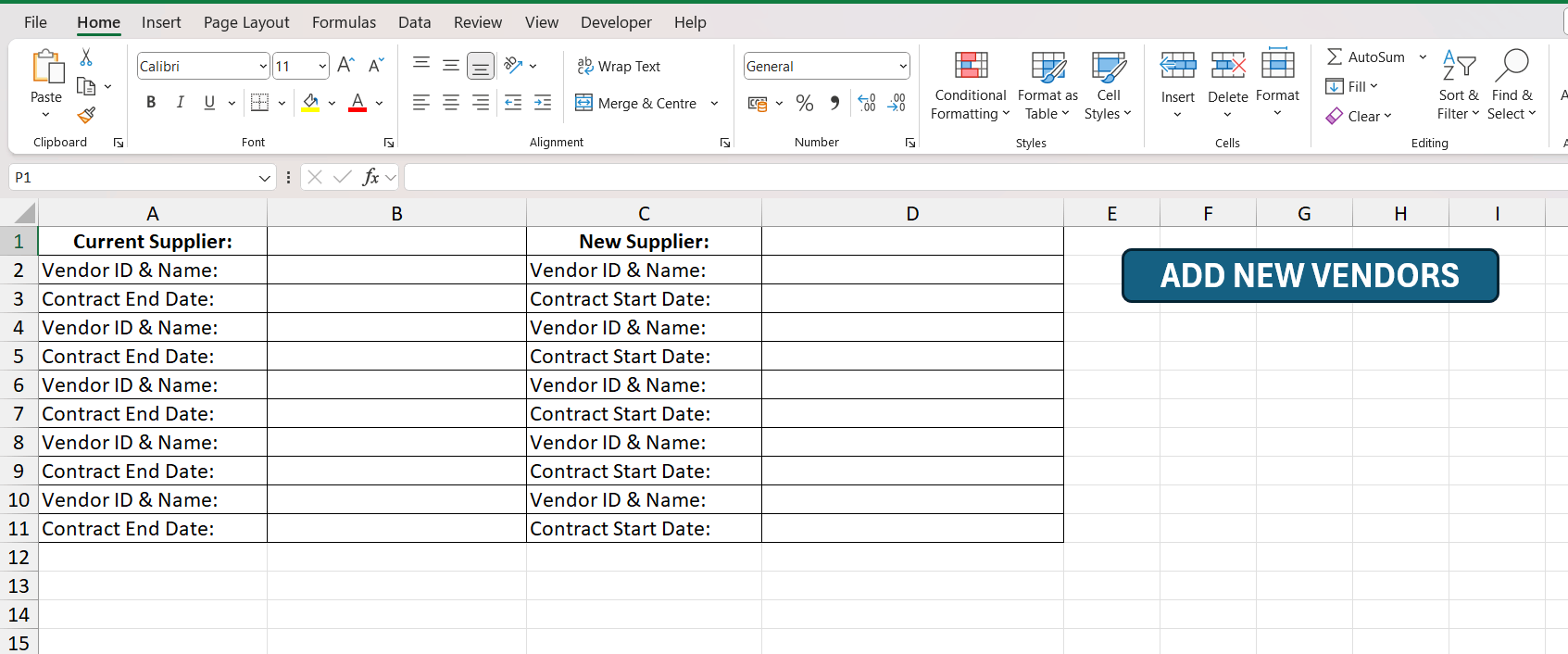

Hello,
Hoping someone could help with adding a macro code to a button.
I'm looking to add a button to a form where I can "add new supplier" which then adds 2 rows with already input data:
So what I have is a section which has:
A2 & C2 'Vendor ID & Name'
A3 & C3 'Contract End Date & Contract Start date'
Current Supplier: New Supplier:
Vendor ID & Name: Vendor ID & Name:
Contract End Date: Contract Start Date:
I basically want to insert a button that when clicked will repeat these 2 rows with the data and blank cells as many times as clicked.
So if i have 5 suppliers I can click 5 times and get 10 rows with the above format
Any help would be much appreciated.

    2024-09-20T10:03:16+00:00
    Hi Jeovany,
    Thanks for the reply. I can get this to work on a new sheet. I just can't get it to work in my worksheet where I need it to add into row 34 and subsequently push down the data below to fit.
    Is there a simple work around for this that I'm missing here?
    Thank you
  5. Anonymous
    2024-09-20T08:54:27+00:00
    Hi Rodney
    Please, try the following macro, based on your description.
    Sub AddNewVendors()
    Dim lrow As Long
    With ActiveSheet
    lrow = .Cells(Rows.Count, "A").End(xlUp).Row + 1
    .Cells(lrow, "A").Value = "Vendor ID & Name:"
    .Cells(lrow, "C").Value = "Vendor ID & Name:"
    .Cells(lrow + 1, "A").Value = "Contract End Date:"
    .Cells(lrow + 1, "C").Value = "Contract Start Date:"
    With .Cells(lrow, "A").Resize(2, 4).Borders
        .LineStyle = xlContinuous
        .Weight = xlThin
    End With
    End With
    End Sub
    You may download the sample file here, https://we.tl/t-ni4bR3lhP3
    Do let me know if you need more help
    Regards
    Jeovany
