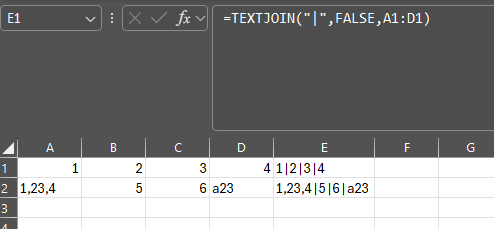

    You may try formula to combine all the cells in to one column. Then paste value only and remove other columns.
    =TEXTJOIN("|",FALSE,A1:D1)
    When you open it as txt format, it will show as below. Then you can set list separator when you want to import to other software.

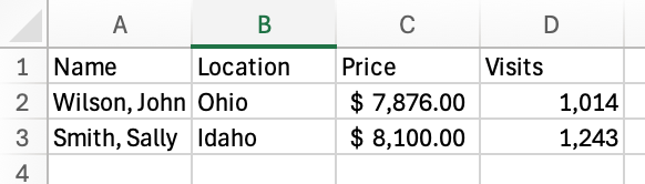

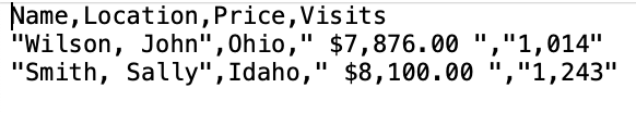

    Are you sure the receiving system must have pipes as field delimiters?
    When Excel generates a CSV it encloses the complete field in quotation marks if it contains a comma.
    For example, if the Excel data is similar to this:
    It appears this way when opened in a text editor:
    The receiving program should not recognize the commas as delimiters if they are withing the quotation marks.
