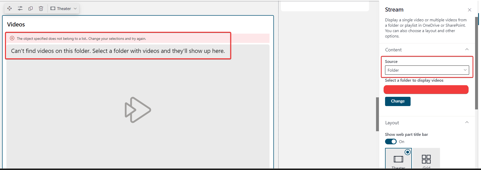

The web part functions perfectly when I select "Videos on this site," "Playlist," or "Single video" as the source. However, when I choose "Folder" and attempt to select a folder, I receive the following error message:
The object specified does not belong to a list. Change your selections and try again. Can't find videos in this folder. Select a folder with videos, and they'll show up here.”
This issue seems to be specific to the "Folder" option. I have double-checked the folder to ensure it contains videos, yet the error persists.
Could someone please assist in identifying the cause of this issue and suggest a solution? I have also attached a snapshot of the error for reference.

    Thank you for your detailed response and for taking the time to test the issue on your end. I followed the steps you provided to create a library using the classic experience and uploaded videos as instructed. However, I am still encountering the same error when I select the "Folder" option in the SharePoint Stream web part.
    While "Videos on this site," "Playlist," and "Single video" work fine, the "Folder" option continues to display the error:
    “The object specified does not belong to a list. Change your selections and try again. Can't find videos in this folder. Select a folder with videos, and they'll show up here.”
    I have ensured that the videos are uploaded to the document library created in the classic experience as per your instructions. Despite this, the issue persists. Is there anything else I could be missing, or are there any additional configurations that need to be checked?

    As per your description, based on my test, it seems that I can also meet the same behaviour as like you described above. When choose "Folder" option we will get error message in SharePoint Stream web part. However, there is no issue when choose "Videos on this site," "Playlist," or "Single video" as the source in SharePoint Stream web part.
    Firstly, please allow me to explain. The choose "Folder" option only work when you save video inside the "document library" via created by classic experience( not a general document library).
    Based on my test, please follow my below steps.
    1.Create a library(video library) via go to SharePoint online site content>Select Settings >Add an App>click on in the classic experience.
    2.Select document library to create:
    3.You will see created document library under site contents:
    4.Access the document library and upload a video.
    5.Then go to your SharePoint online Stream web part>select the document library>choose Folder and video will appear.
