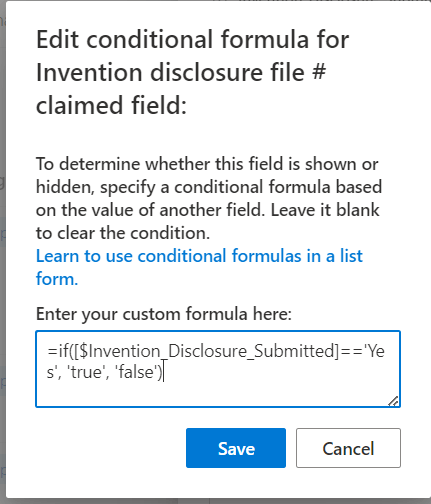

Hello everyone,
I have 2 columns in my Sharepoint list and I am trying to conditionally format the second column to only display when the answer to the question in the first column is "Yes" (it's a choice type column with options for Yes and No).
My formula is getting accepted, and the second column is hidden when I add a new entry to my list, but it does not then get displayed despite choosing "Yes" in my first question.
Here is my formula : =if([$Invention_Disclosure_Submitted]=='Yes', 'true', 'false')
My first column name is Invention_Disclosure_Submitted.
What am I doing wrong here? I tried multiple ways, by renaming columns to a single worded title, but all fails.
Thank you very much for your help in advance.

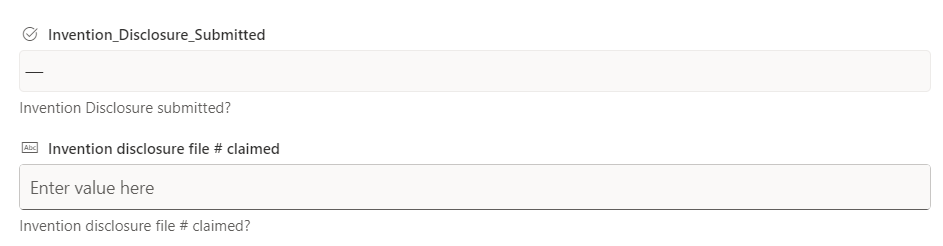

    2024-08-07T09:26:41+00:00
    Hello Sophia,
    Thanks for your quick reply and your assistance, I appreciate it.
    Yes, I mentioned in the first sentence in the bracket that (it's a choice type column with options for Yes and No), so I have already set up column Invention_Disclosure_Submitted in the type choice.
    I will attach a screenshot for you to check. There are only two options in it, Yes and No. This condition formatting is hiding the second column I need hidden, but not showing it when I select "Yes".
    What else might be going wrong here?
    Thanks for your help
