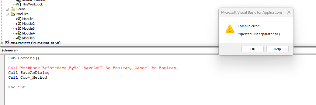

Andreas Killer 144.1K Reputation points Volunteer Moderator
2024-11-06T15:15:12+00:00
Gaye,
Whatever the point of this should be, it will never work that way.
Workbook_BeforeSave is an event routine (placed in the code module ThisWorkbook), that is called automatically from the application.
Therefore there is no need and it makes no sense to call it and, as the routine is declared Private, no way to call it from a regular module.

    Hello, Andreas. Thank you for your help. Yes, the restructured header now works.
    However, when I try to Combine the macros for my Save As button, an error highlights "As" and indicates that there is an "Expected: list separator or )"
    I've been going in circles...when I change one thing, another error pops up. Your thoughts?
    Gaye
