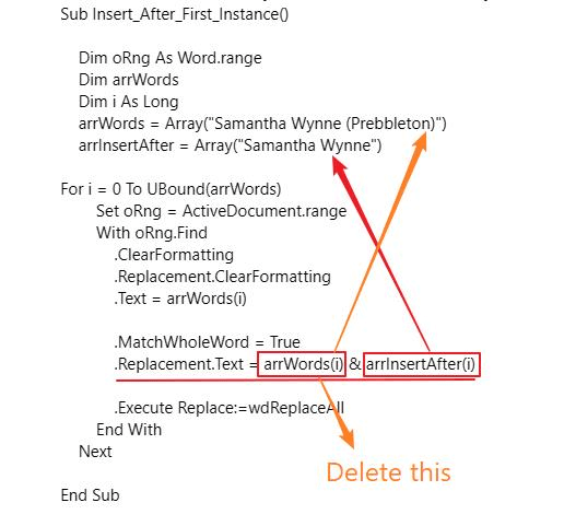

Oh, in your original message, you mentioned "change the first instance only." So I thought you only needed to modify the first instance. I apologize for misunderstanding your requirement.
If you need to modify all instances, you can simply remove the part "arrWords(i) &" as mentioned in the image above.
Or you can copy the code below and overwrite your macro:

    2024-11-14T04:55:03+00:00
    Hi Steve,
    This is our first meeting in November, and I am glad to see you again.
    I checked the code you shared, and the issue lies in concatenating the original text and the insert text during the replacement. You only need to remove the command that appends the original text in the replacement statement.
    In addition, the macro will also replace all instances of "Samantha Wynne (Prebbleton)" with "Samantha Wynne (Prebbleton)Samantha Wynne." This does not meet your requirements. An additional layer of logic is needed to make the macro exit the loop after the first match.
    You can also copy the following code to replace your macro.
