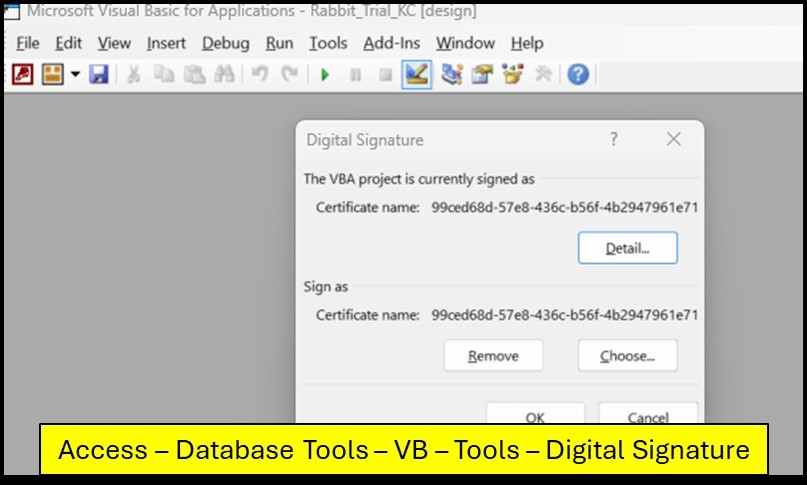

I made a trial table & form to test out this process.  I’ve successfully been able to set up Azure with my SQL database and make a connection with SSMS.  I’ve also been able to link a table in Access to the SQL Server and successfully make changes both ways:

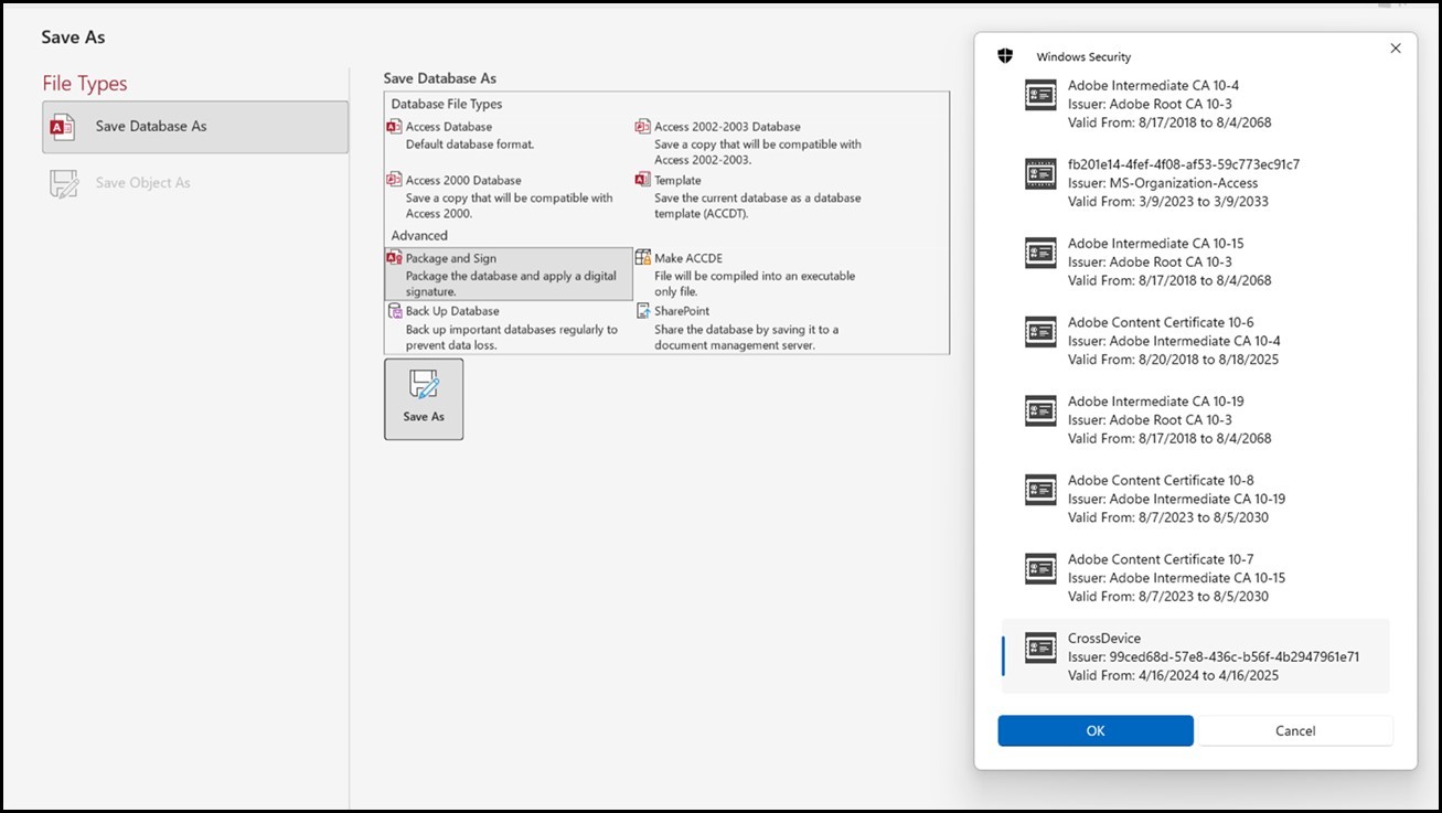

What I’m confused about doing and running into trouble with is how to build & distribute the front end of my Microsoft Access to users.  I’ve looked up many tutorials and tried many examples.  I’ve went into the VBA in Access to set up a digital signature.  I then saved the document under “Package & Sign”, and a different one as “Make ACCDE”.  I tried trialing the program out on a separate laptop that DOES NOT have Microsoft Suite or Microsoft 365 – I installed Access Runtime.  When I try to open the “Package/Sign” or the “ACCDE” file, it did not work.  I had to install a certificate in the trust directory.  After that, Access Runtime opened, but the screen was blank and did not show my form.  Hopefully all of this makes sense, but basically, I need help in how to close the loop in distributing a final Access “App” to my end user so that it is connected to my SQL server on Azure.
