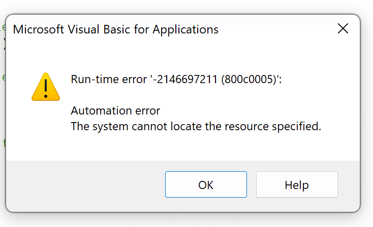

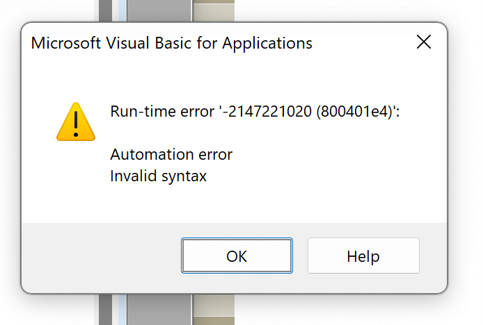

I am trying to download a file (historical Prime Interest rate) from the internet.
I am using the following code:
Sub DownloadHistoricalPrimeRates()
    Dim URL As String
    Dim FilePath As String
    Dim HTTP As Object
    Dim Stream As Object
    ' URL of the file to download
    URL = "blob:https://wowa.ca/c9c80084-6aa5-447a-8c54-3b1c58ab67f3"
    ' Path where the file will be saved (include file name and extension)
    FilePath = "\\Mac\iCloud\Differentiated Solutions\Model\Historical CORRA, DSIR and Prime\Preime-rate-History-wowa.csv"
    ' Create XMLHTTP object for file download
    Set HTTP = CreateObject("MSXML2.XMLHTTP")
    ' Create ADODB Stream object to write the file
    Set Stream = CreateObject("ADODB.Stream")
    ' Initialize request to download the file
    HTTP.Open "GET", URL, False
    HTTP.Send
    ' Check if the request was successful (status code 200)
    If HTTP.Status = 200 Then
        ' Open the stream and set properties
        Stream.Open
        Stream.Type = 1 ' Binary
        Stream.Write HTTP.responseBody
        ' Save the downloaded file to the specified path
        Stream.SaveToFile FilePath, 2 ' 2 = overwrite if file exists
        ' Close the stream
        Stream.Close
        MsgBox "File downloaded successfully!"
    Else
        MsgBox "Failed to download the file. HTTP Status: " & HTTP.Status
    End If
    ' Clean up
    Set HTTP = Nothing
    Set Stream = Nothing
End Sub
I am getting the following error message
I woudl appreciate help in getting this to work.
Thank you!

    2024-10-06T23:32:30+00:00
    blob:https://wowa.ca/c9c80084-6aa5-447a-8c54-3b1c58ab67f3 is not valid url
    try replace it with http://e.anyoupin.cn/ceshi/viewdocx/docx/2.xlsx for testing your codes .

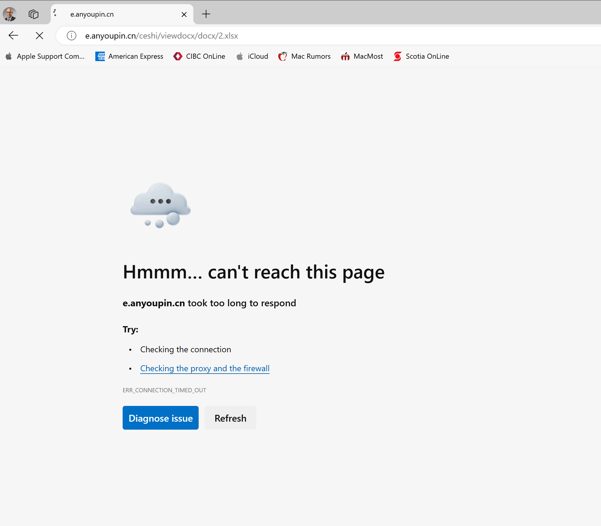

    2024-10-07T00:34:33+00:00
    Appreciated but it still does not work.
    I am not getting the following error message:
    Still looking for a fix!
    Thanks.
    2024-10-07T01:06:40+00:00
    This is because http://e.anyoupin.cn/ceshi/viewdocx/docx/2.xlsx
    has been blocked by your system.
    Can you visit it by Edge web browser?

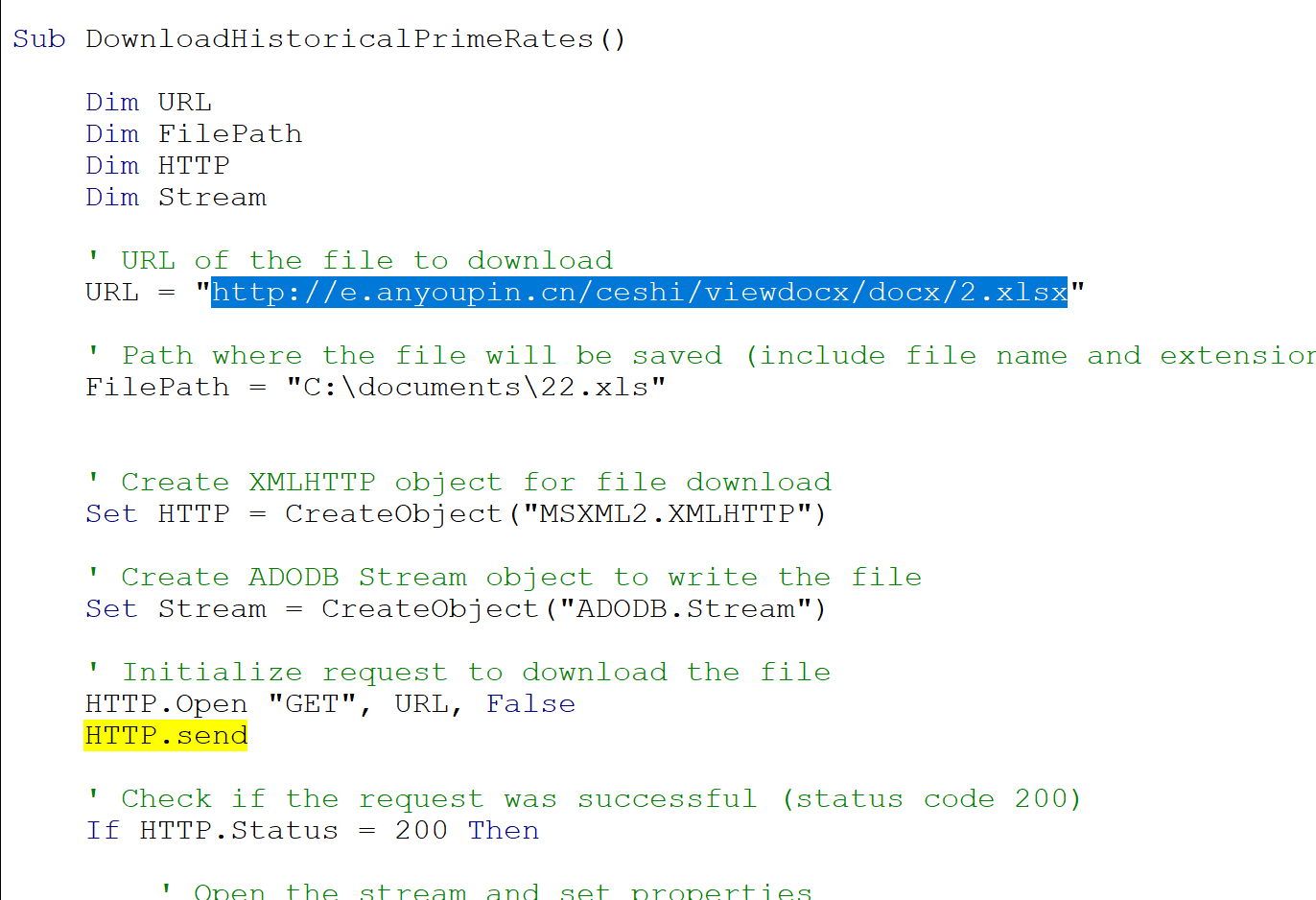

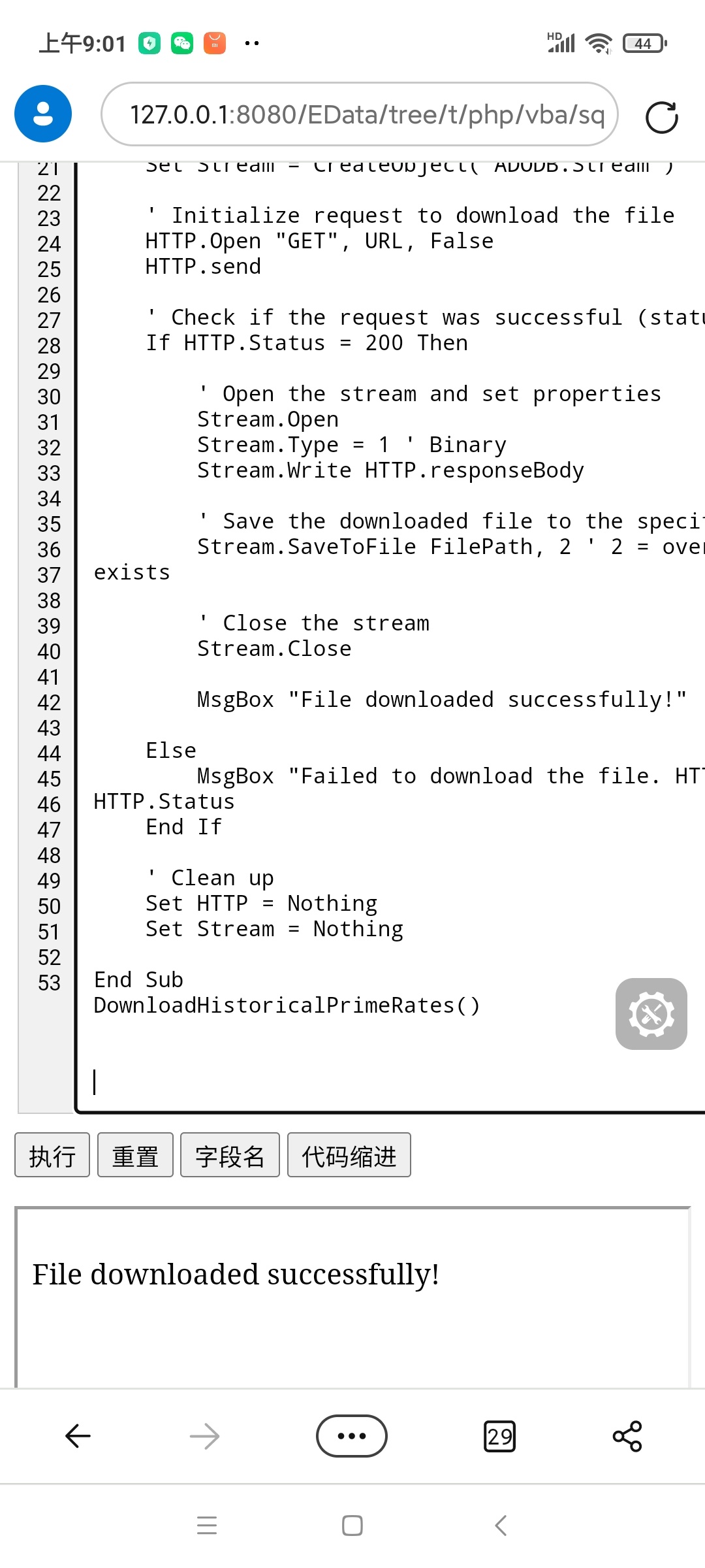

    The codes did download the file to my local disk drive as expected when I tested on my side.
        Dim URL
        Dim FilePath
        Dim HTTP
        Dim Stream
        URL = "http://e.anyoupin.cn/ceshi/viewdocx/docx/2.xlsx"
        FilePath="D:\wwwroot\HA626046\WEB\Bsbm\stu60\vba\up\upload\22.xls"
        HTTP.send
            Stream.Open
            ' Close the stream
            Stream.Close
        Else
        End If
        ' Clean up
        Set HTTP = Nothing
    End Sub

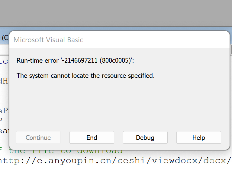

    2024-10-07T01:33:59+00:00
    Appreciate all the assistance noting:
    I copied your code into a brand new workbook noting I still cannot reach the file as noted by:
    1. I cannot reach it via Microsoft Edge. I get the following:
    1. The script is chocking at th send command as noted by
    The error message I get is as follows:
    Thanks.

    2024-10-07T01:46:54+00:00
    Additional update.
    I tried a link that can access the file target file (i.e., I get the MSFT Edge dialogue box asking me to save the file).
    The code still chokes at the HTTP.send command.
