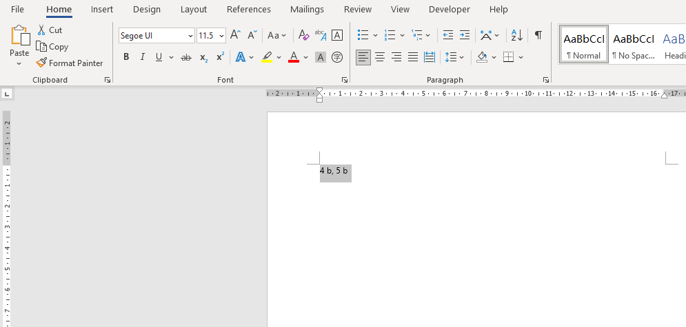

Before running:

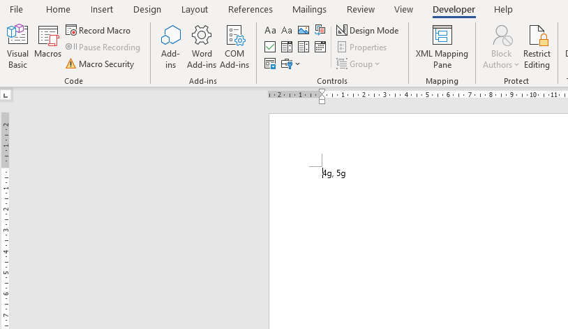

After running:

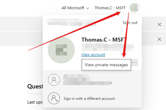

I also shared this document with you in a private message. Please check again if it runs correctly.
