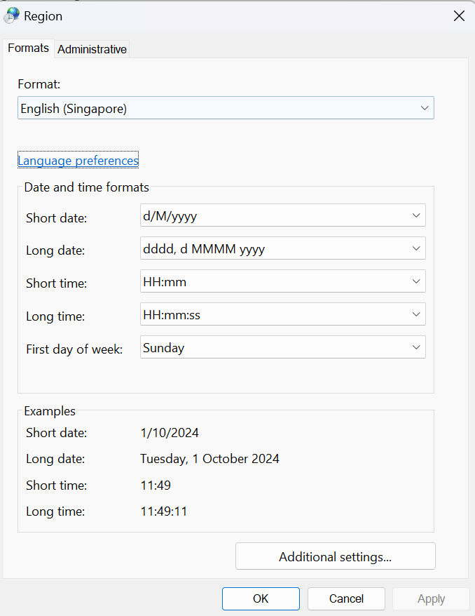

I set up my laptop with REGIONAL FORMAT = ENGLISH (SINGAPORE). (the picture below)
There is any way to use MACRO but DATE column will be automatically formatted like 4/9/2024 (4 Sep 2024) the same as I make manually?
