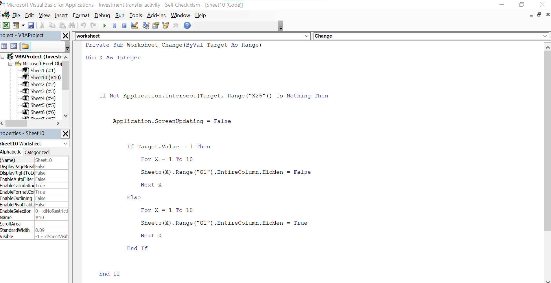

I am having trouble with a macro in excel. I can't seem to write a macro that will hide/unhide one column on all 10 sheets. The thought is if the value in cell X26 on sheet 10 is 1, column G on sheets 1-10 is visible. If the value in X26 on sheet 10 is anything else, it's hits. I've spent alot of hours on this and I can't seem to figure out what I am doing wrong. My goal is not to use a button. I just want to change the value to make the macro work. I am appreciate any help you can provide. Thanks!

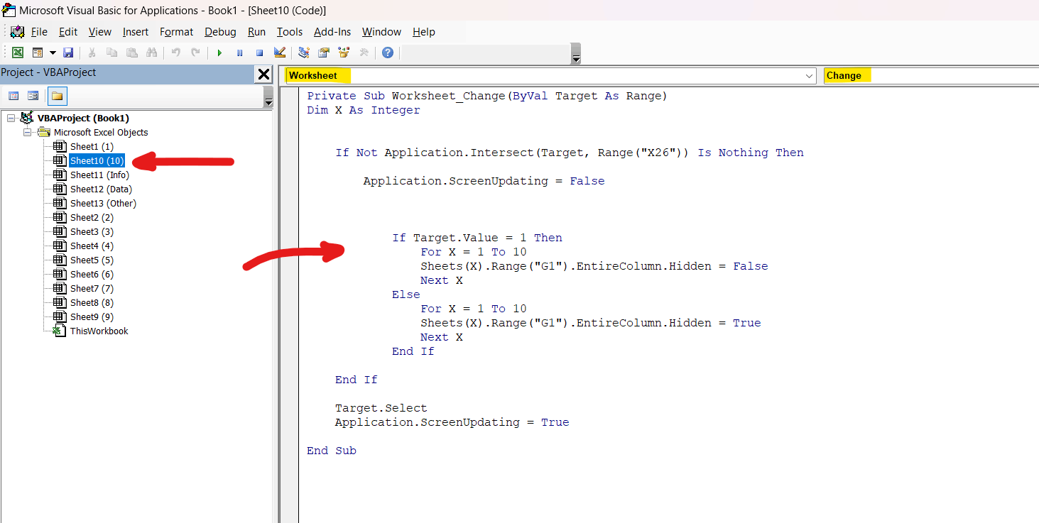

    Hi Chis
    The following macro is NOT for a regular module, it belongs to the Worksheet_Change event panel as shown in the picture below.
    Here is the code
    Private Sub Worksheet_Change(ByVal Target As Range)
    Dim X As Integer
    If Not Application.Intersect(Target, Range("X26")) Is Nothing Then
        Application.ScreenUpdating = False
            If Target.Value = 1 Then
                For X = 1 To 10
                Sheets(X).Range("G1").EntireColumn.Hidden = False
                Next X
            Else
                For X = 1 To 10
                Sheets(X).Range("G1").EntireColumn.Hidden = True
                Next X
            End If
    End If
    Target.Select
    Application.ScreenUpdating = True
    End Sub
    Do let me know if you need more help
    Regards
    Jeovany

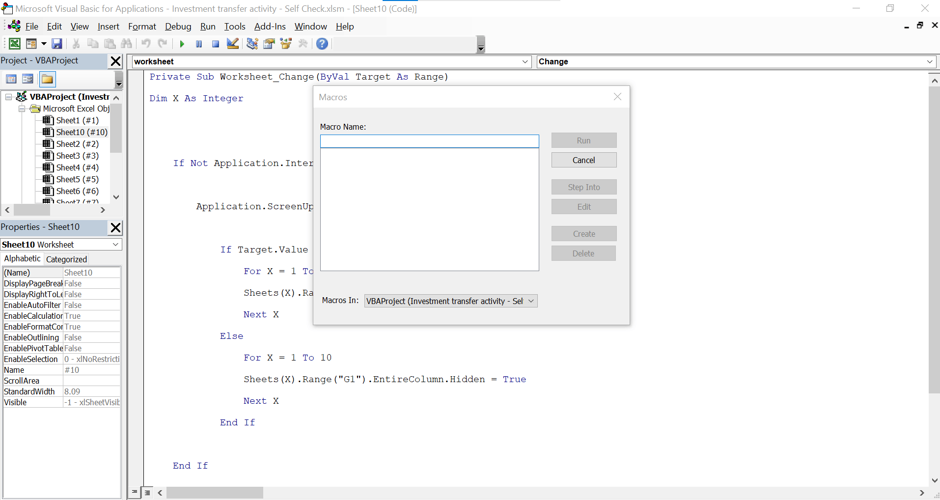

    Thanks for the help, Jeovany. When I put the code in the worksheet and hit run, the Macro name box shows up. I won't let me run the private sub without putting something in there. Please see below.
    It's like it wants me to put something the module box. When I do and try to find a call sub, it doesn't seem to work.
    Thanks!
    2024-10-06T05:32:50+00:00
    Nevermind. You're a genius. I was trying to click run when I didn't have to. Once I changed the code to look at the correct cell, everything worked! Thank you so much.

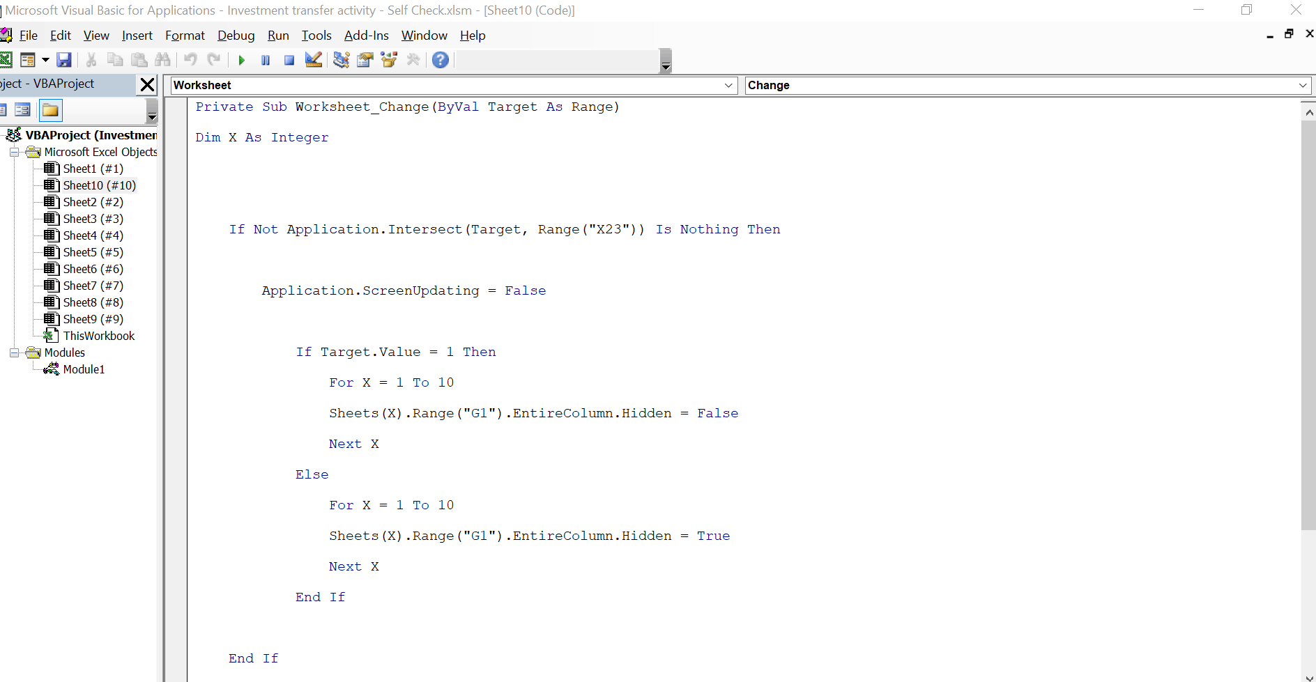

    Hi Jeovany,
    Sorry about the additional message. I went to save my workbook and now the macro won't run after I reopened it. I can't figure out why. Here is the current code I have:
    I was working before I saved it and then when I went to close and reopen, I won't work anymore. The only change in I made in your code was the cell I was using in sheet 10. It's X 23. What I have in the module is nothing. Am I supposed to use a call function in the module to have this macro work or is there a setting that I need to make sure I have enabled? It was working just fine before I closed it.
    Thanks,
    Chris
    2024-10-06T13:20:11+00:00
    Nevermind again. Apparently, I just need to take a break and come back to find my error. Thanks again!
