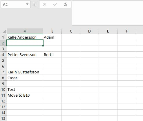

    2024-11-04T02:46:03+00:00
    Hi Hans Peter Wiehen,
    Thanks for your post in Microsoft Community.
    Please try the following macro program:
    Sub MoveValues()
        Dim lastRow As Long
        Dim i As Long
        lastRow = Cells(Rows.count, 1).End(xlUp).Row
        If lastRow >= 2 Then
            Cells(1, 2).value = Cells(2, 1).value
            Cells(2, 1).ClearContents
            For i = 5 To lastRow Step 3
                Cells(i - 1, 2).value = Cells(i, 1).value
                Cells(i, 1).ClearContents
            Next i
        End If
    End Sub
    Before running the macro:
    After running the macro:
    I hope the macro I shared works for you too, and I look forward to your reply!
