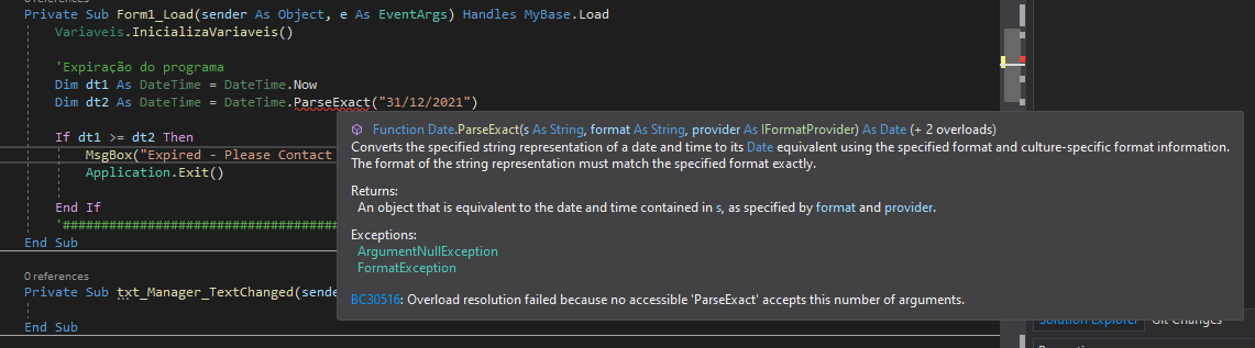

I would like to put an expiration date on my program, so that it doesn't run when it reaches the stipulated date. I'm using code below, and it works fine when I run on computers with "dd/mm/yyyy" date format, but when I run on computers with "mm/dd/yyy" date format, the condition doesn't work, and the program is executed. How can I use a condition that works on both date formats?
Dim dt1 As DateTime = DateTime.Now
Dim dt2 As DateTime = DateTime.Parse("31/12/2021")
        If dt1 >= dt2 Then
            MsgBox("Expired - Please Contact the Administrator")
            Application.Exit()
        End If

  1. Xingyu Zhao-MSFT 5,381 Reputation points
    2021-09-03T03:02:53.06+00:00
    Hi @Sergio Siqueira ,
    Use the following code to convert the date to "dd/MM/yyyy" date format.
    Dim dt2 = DateTime.ParseExact("31/12/2021", "dd/MM/yyyy", Nothing)
    Convert to "MM/dd/yyyy" format.
    dt2.ToString("MM/dd/yyyy")
    Hope it could be helpful.

  1. Castorix31 90,521 Reputation points
    2021-09-02T17:12:12.617+00:00
    You can use DateTime.ParseExact
    (but if the user can change the System date, your test won't work...)
  2. Sergio Siqueira 41 Reputation points
    2021-09-03T02:16:41.397+00:00
    I found out, now it's working
    Than you a lot
    Dim provider As New CultureInfo("en-US")
            Dim dt1 As Date = System.DateTime.Now
            Dim dt2 As DateTime = DateTime.ParseExact("31-12-2020", "mm-dd-yyyy", provider)
            If dt1 >= dt2 Then
                MsgBox("Expirou a Validade - Favor Contactar SERGIORS@")
                Me.Close()
            End If
