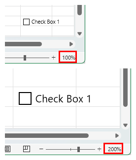

    You cannot change the size of the Form Control check box, except by increasing the zoom percentage of the sheet:
    2024-10-13T09:26:00+00:00
    Hi, unfortunately, that doesn't help me while I take print outs with respect to the scale of the other contents in the table. But thankyou for reaching out.
