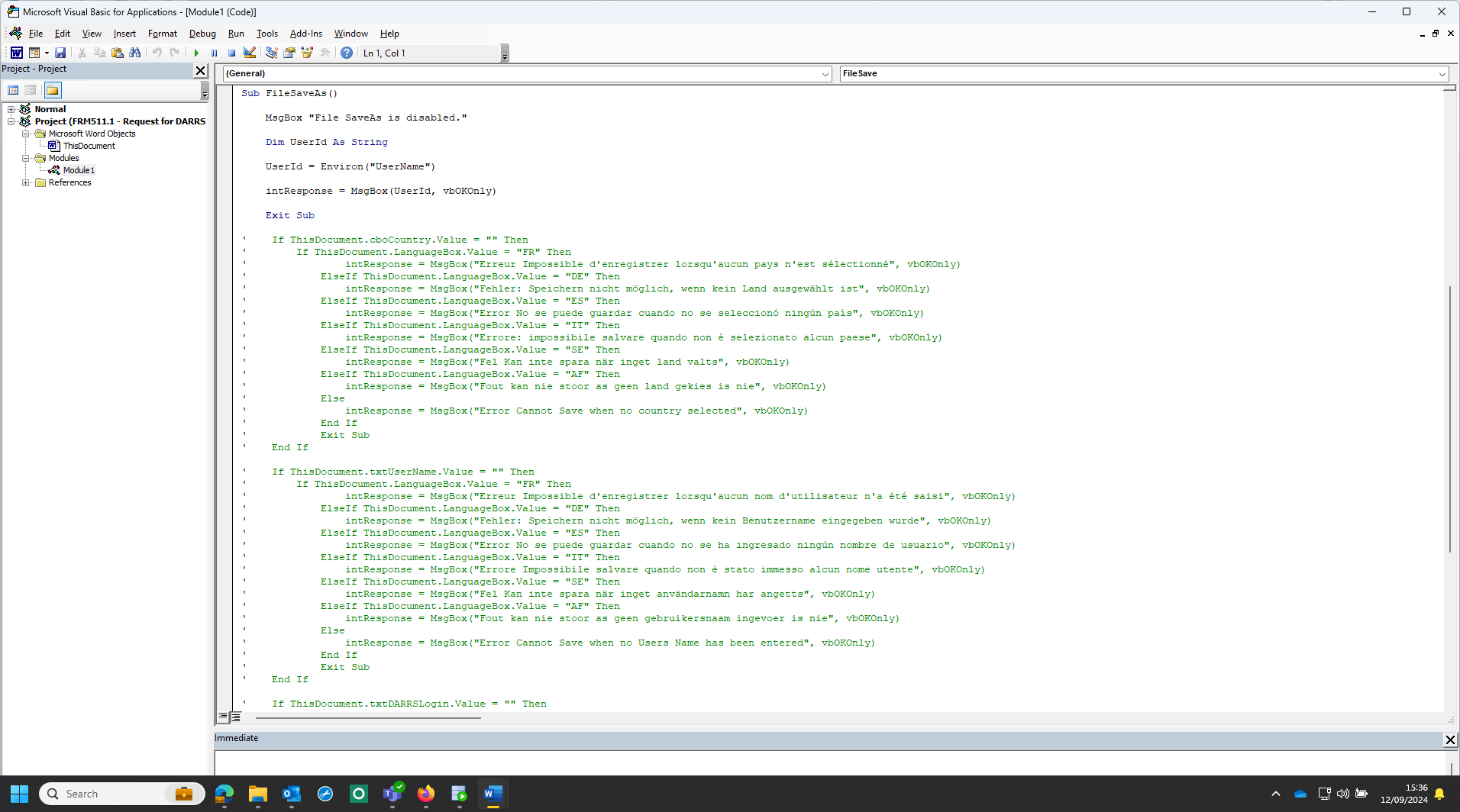

I have developed some forms in Word. Documents are locked so that users can only fill in the fields in the form. I have code in the Save event for the document that throws a message to the user that they must use the "Save Form" button in the form - this button vaildates that the users have filled in the form correctly then saves the completed document to their downloads directory with a specific file name based on the information entered.
However some users seem incapable of following what the are supposed to do and I need to lock down the functionality
What I would like to do is to put code into the File SaveAs macro that will prevent users from using File SaveAs unless they are specific user id's. However whatever I put into the File SaveAs macro makes no difference, it just comes up with the standard "SaveAs" dialogue.
Is it not possible to modify the behaviour of SaveAs in Word (we are using Microsoft Office 365).

    Charles,
    In order to limit the users who can use SaveAs I plan to capture and test the user's windows login (Environ("username")) and block users in code where they are not in a list of approved users. However my problem is that whatever I try if you select SaveAs from the File menu it does not call the VBA FileSaveAs code. If I can find how to make it call the FileSaveAs code I should be alright.
    Background is that I have created a Form in word using active X controls and have a "Save Form" button in the document when pressed the VBA code in the FileSave procedure validates that the user has completed the form correctly then saves the form to the users "Downloads" directory with a specific file name based on information entered. However some of our users go to extraordinary lengths to try and not do what they are supposed to e.g. using File SaveAs and I need to stop them.
    All I need to find out is how to make the VBA code in FileSaveAs fire if the user tries to use File Menu -> SaveAs in the document.
  2. Charles Kenyon 167.8K Reputation points Volunteer Moderator
    2024-09-12T16:37:26+00:00
    I know of no way to limit the SaveAs command to certain users.
    You can substitute your process for the saveAs, though.
    Please copy your code from the vbe and post it here rather than a screenshot.

    2024-09-12T14:38:09+00:00
    "I'm afraid you may need to use VBA macro solution to modify the behavior of SaveAs in Word"
    I have been trying to use a VBA macro to modify the SaveAs option on the File Menu, however whatever I put in the macro it seems to be ignored. The code below does not display the message box, just the standard SaveAs dialogue when called from the File menu.
