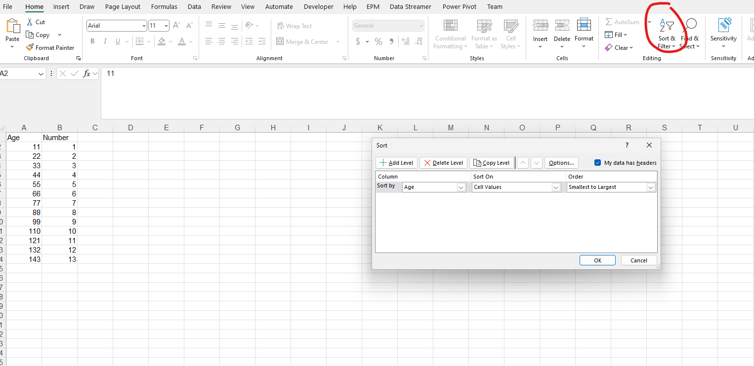

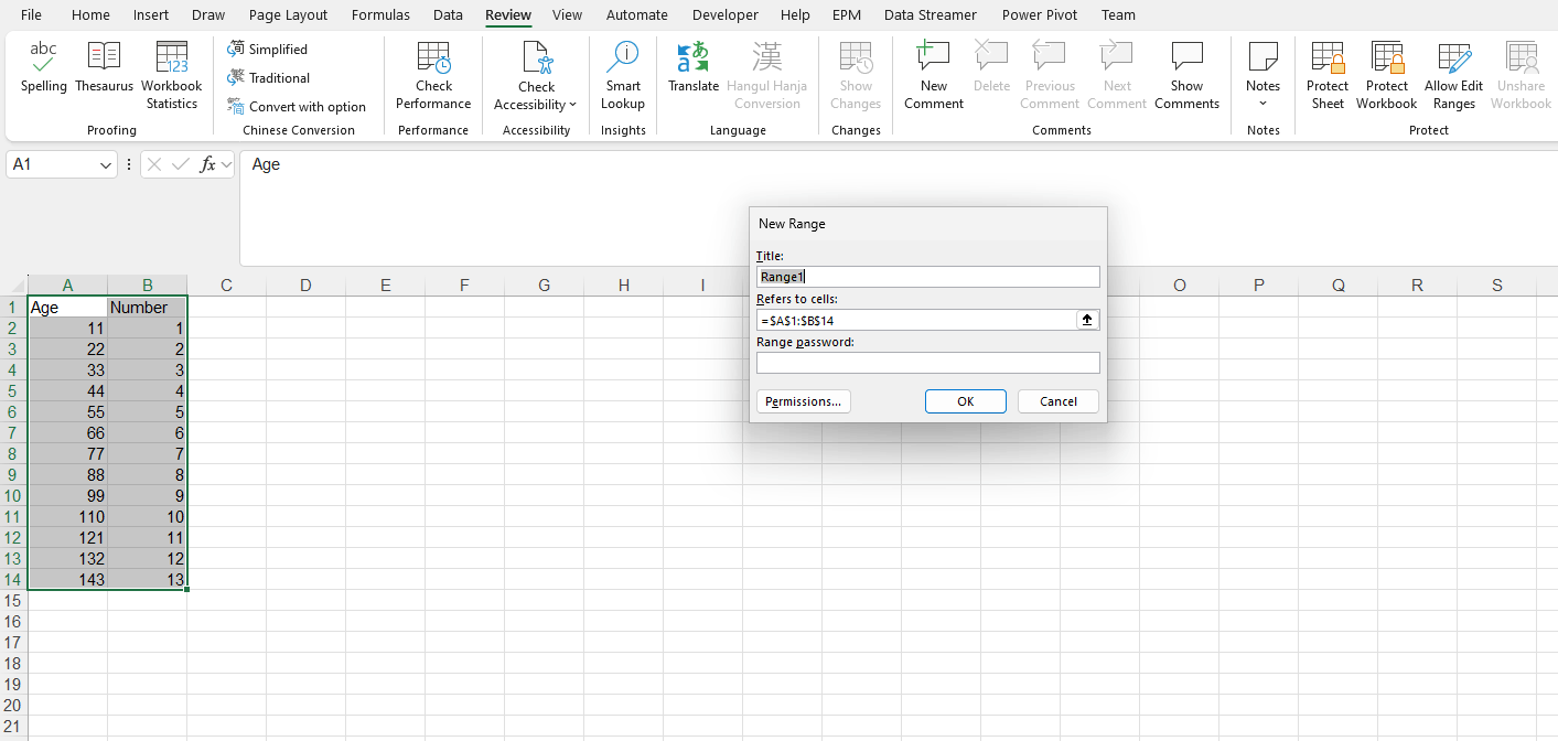

    You can try my scenario:
    Allow the edit range first - then don't set a password - click confirm.

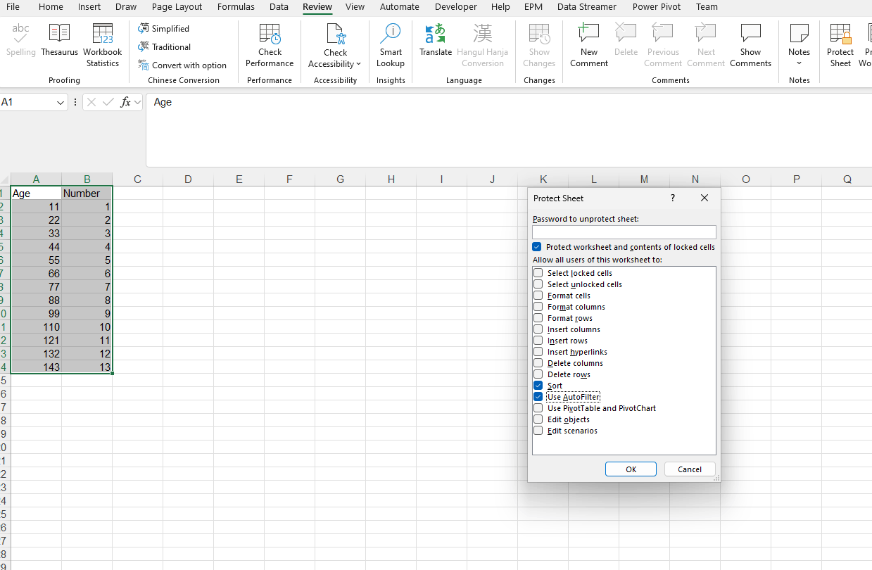

    Next select Protect Worksheet - uncheck the box to select locked/unlocked cells and then select Sort By:.
    Then just sort through that:
    But it should be noted that sorting is for the whole, for a single column cannot be done, if you want to do the sorting of a single column, then it will involve your cells can be edited (that is, allow editors to set a password, and then protect the worksheet check box to choose to lock/unlock the cell of the situation). As well as if you're filtering you need to do it in advance:

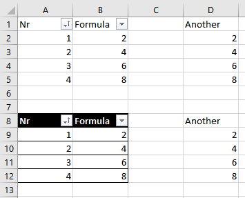

    Simple scenario:
    B2: =A2*2
    D2: =A2*2
    B9: =[@Nr]*2
    D9: =Table1[@Nr]*2
    If we unlock the cells in A:B, protect the sheet and allow sorting we can sort the sheet (A1:B5) as we like and also the table (A8:B12) as we like.
    But if we lock the cells in column B we can not sort anymore. This is a known issue for decades.
    The only workaround, if you have formulas ONLY in the other columns, is to separate them from the data to be sorted, as I did in column D. The empty column C separate the formulas from the data.
