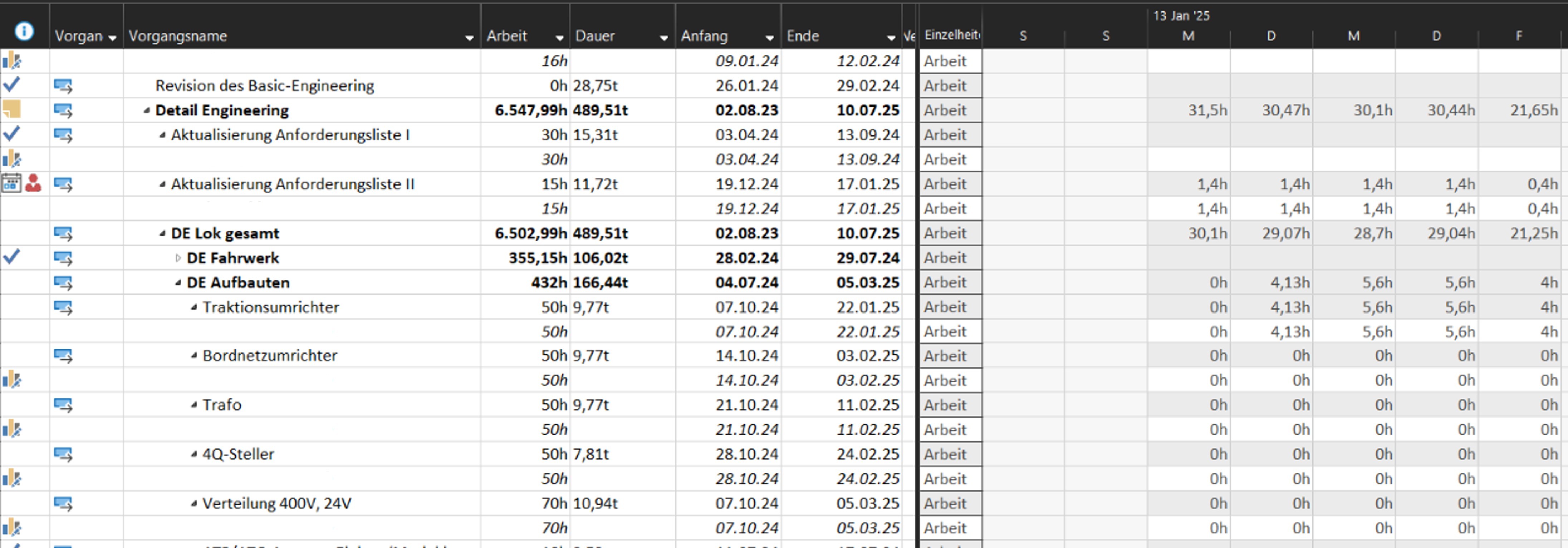

Dear community,
I'm searching for a way to transfer specific data from MS Project into Excel.
I know the basic way but it doesn't transfer the data I'm looking for.

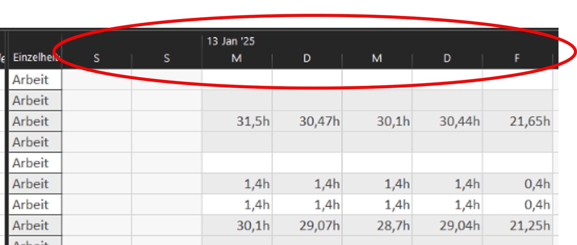

I want to get the data from the left and the right side of the attached view into Excel.
In German the view ist called "Vorgang: Einsatz"
All attempts so far transfered only the data of the left side

    2025-01-11T06:52:14+00:00
    Alex, I do this every day with copy/paste. It is a lot easier to copy the data from the right hand side grid if you first reduce the timescale resolution right down to very thin, and it can still be copied even if the columns are so thin that the cells display as ####.
    Of course, once the data is in excel you need to run a replace to get rid of the "h".

    Alex Geldmacher,
    Indeed VBA is the way to go but the code you need is more involved than the simplistic code posted by Narendra. I have several VBA macros that export Project data to Excel and some of the macros export time scaled data (right side of Task Usage view). From your initial screen shot it looks like you want daily man hours as shown on the Task Usage view. Is that all you need or do you also want other time scaled data?
    If you are interested, you can contact me at the below address. I will ask some questions.
    John
    jmacprojataticlouddotdotcom
    (remove obvious redundancies)

    Dear Naren,
    thank you for your super fast and detailed reply.
    I tried the steps 1. to 5. that you describe above already.
    But whatever I try, only the data on the left side is transfered, means content from the columns like "Task Name", "Start Date", "Finish Date", "Resource Names", "Work", etc.
    The data from the right side, means the specific allocation of hours per day to the line item on the left side and with that to the task and the ressource is, what I need to create a forcast for the next week (who will do what and how many hours will they spent).
    As these columns on the right side don't have the names/headlines that can be chosen in the export wizard I can't select them during the process.
    The columns I need have sort of unspecific headlines naming the day the the work will happen, means "M,D,D,D,F" so I don'T know how to tell the wizard to export this data.
    I don't have much expertise in VBA but from looking at the skript you added, it seems that the skript is also adressing the columns on the left and will not cover the columns on the right.
    Anyhow, thank you very much for your support, I will try the way via VBA, if I find someone with the specific expertise.
