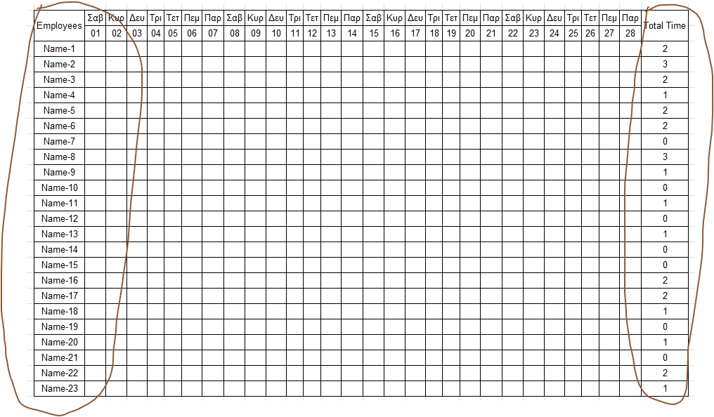

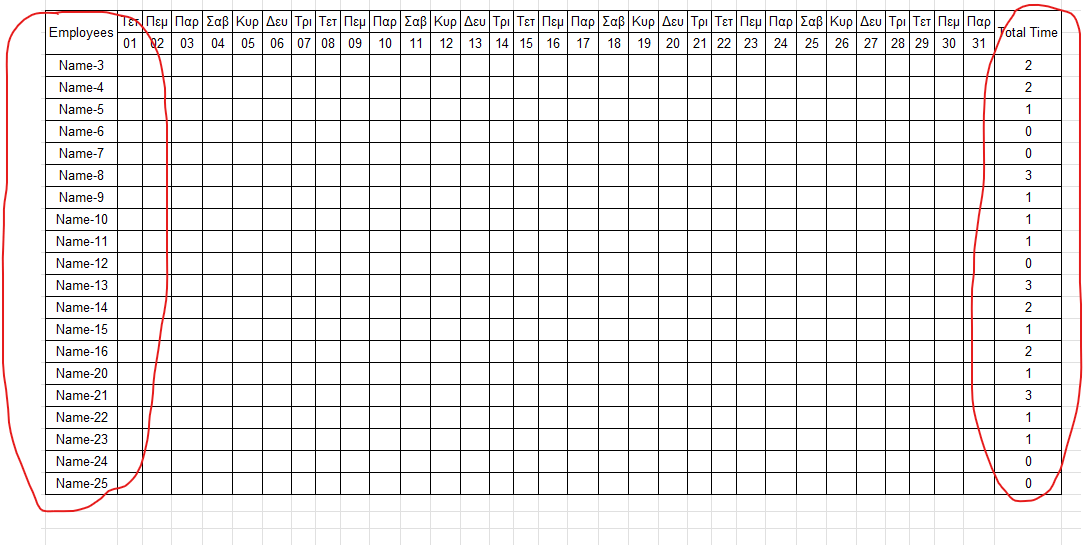

    2025-03-23T09:48:07+00:00
    sample
    scenario
    12 months in active workbook
    month names: Jan, Feb,... Dec / change names as needed
    employee names in column B, starting from row 8
    total column, the last column in each sheet / month

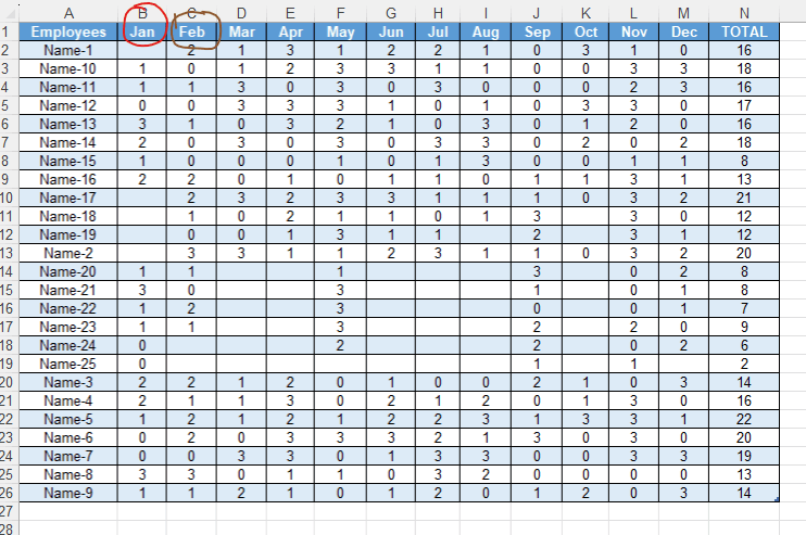

    result in a new sheet like below:
    sample: Jan and Feb 2025
    1/ Jan
    2/ feb
    step1
    Save  your Workbook with extension .xlsm (macros enabled workbook)
    Step2
    2a) press ALT+F11 to open Visual Basic
    2b) from the ribbon, select: Insert > Module and paste the code below on the right
    [Update-3]
    '/// START VBA ///
    Option Explicit
    Dim cColl As New Collection
    Dim ws, lo, rng, r, L, x, t, rFind1, rFind11, rFind2, nRow, nCol, v, vv, cc
    Sub Get_Data_from_12months()
    ' ## 24/03/2025 ##
    '// employee names , in column B, starting from row 9
    nRow = 9
    nCol = 2 ' 2=column-B
    ' << month sheet names / change as needed >>
    v = Array("Jan", "Feb", "Mar", "Apr", "May", "Jun", "Jul", "Aug", "Sep", "Oct", "Nov", "Dec")
    Application.ScreenUpdating = False
    For Each vv In v
    L = Sheets(vv).Cells(Rows.Count, nCol).End(xlUp).Row
    On Error Resume Next
    For x = nRow To L
    cColl.Add Sheets(vv).Cells(x, nCol), Sheets(vv).Cells(x, nCol)
    Next x
    On Error GoTo 0
    Next vv 'AAA
    Set ws = Sheets.Add
    ws.Cells(1, 1) = "Employees"
    ws.Cells(1, 2).Resize(, 12) = v
    ws.Cells(1, 14).Value = "TOTAL"
    t = 2
    For Each cc In cColl
    ws.Cells(t, 1).Value = cc
    t = t + 1
    Next cc
    ws.UsedRange.EntireColumn.AutoFit
    t = 2
    For Each vv In v
    Set rFind1 = Sheets(vv).Columns(nCol).Find(What:=cc, LookAt:=xlWhole)
    If rFind1 Is Nothing Then
    'nothing
    Else
    Set rFind11 = ws.Range("A:A").Find(What:=cc, LookAt:=xlWhole)
    'Set rFind2 = Sheets(vv).UsedRange.Find(What:="Total*", LookAt:=xlPart)
    Set rFind2 = Intersect(Sheets(vv).UsedRange, Sheets(vv).Rows("1:" & nRow - 1)).Find(What:="Total*", LookAt:=xlPart)
    ws.Cells(rFind11.Row, t).Value = Sheets(vv).Cells(rFind1.Row, rFind2.Column).Value
    End If
    Next cc
    t = t + 1
    Next vv
    L = ws.Cells(Rows.Count, 1).End(xlUp).Row
    For x = 2 To L
    ws.Cells(x, 14).FormulaR1C1 = "=SUM(RC[-12]:RC[-1])"
    Next x
    Set rng = ws.Range("A1").CurrentRegion
    Set lo = ws.ListObjects.Add(xlSrcRange, rng, , xlYes)
    lo.ShowAutoFilterDropDown = False
    lo.DataBodyRange.Value = lo.DataBodyRange.Value
    With rng
    .Borders.LineStyle = xlContinuous
    .HorizontalAlignment = xlCenter
    .VerticalAlignment = xlCenter
    End With
    With ws.Sort
    .SortFields.Clear
    .SortFields.Add Key:=lo.ListColumns(1).DataBodyRange, SortOn:=xlSortOnValues, Order:=xlAscending, DataOption:=xlSortNormal
    .SetRange lo.Range
    .Header = xlYes
    .MatchCase = False
    .Orientation = xlTopToBottom
    .SortMethod = xlPinYin
    .Apply
    End With
    For Each r In rng
    If r.Value = 0 Then r.Value = ""
    Next '>>
    Set cColl = Nothing
    Application.ScreenUpdating = True
    End Sub
    '/// END VBA ///
    2c) Press ALT+Q to Close Visual Basic
    Step3
    To run the macro, press ALT+F8,
    *select '****Get_Data_from_12months'***from the list and click the run button.

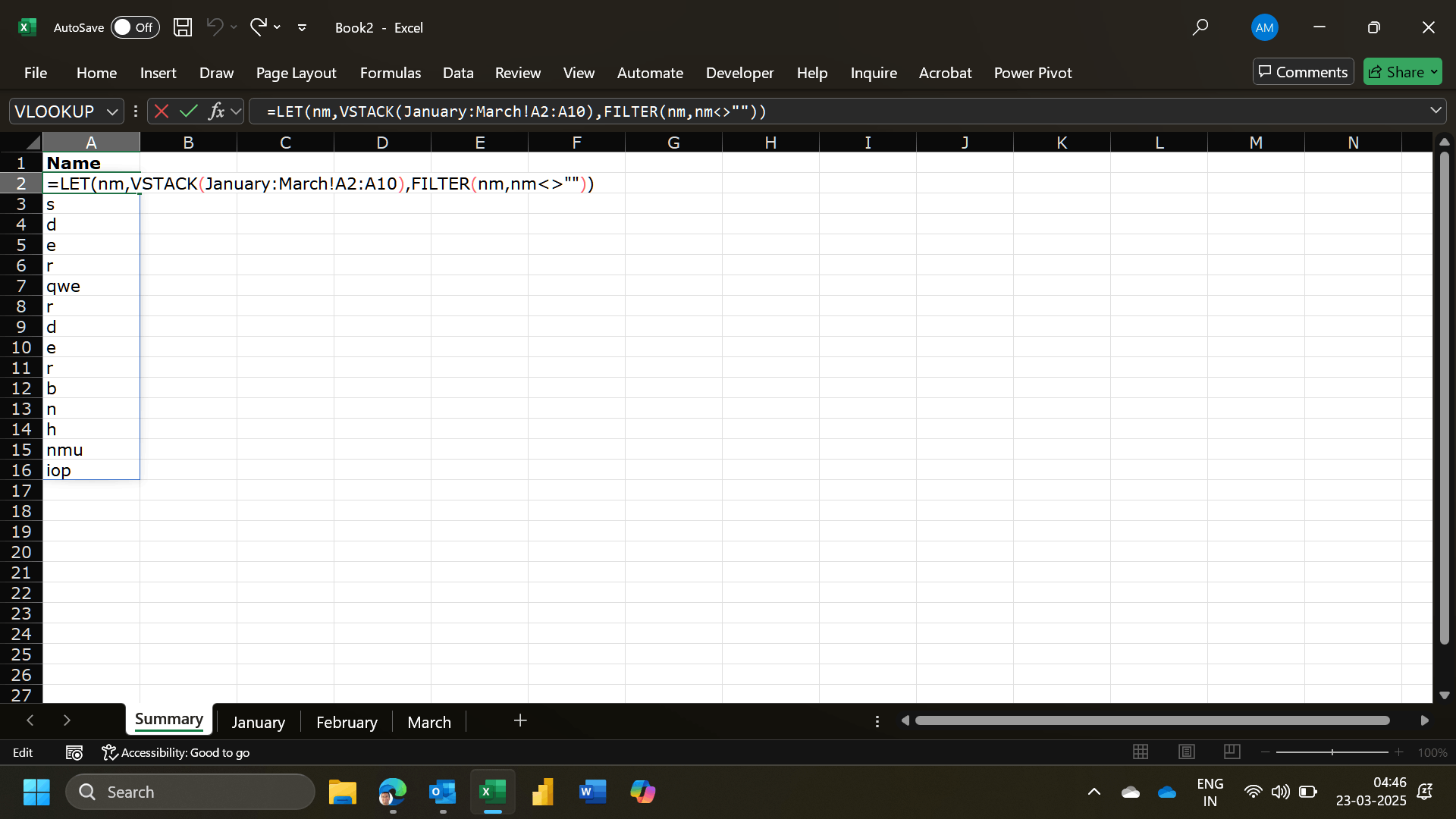

  2. Ashish Mathur 102K Reputation points Volunteer Moderator
    2025-03-23T05:32:35+00:00
    Try this
    =LET(nm,VSTACK(January:March!A2:A10),unique(FILTER(nm,nm<>"")))
  3. Deleted
  4. Deleted
  5. Ashish Mathur 102K Reputation points Volunteer Moderator
    2025-03-22T23:16:20+00:00
    In cell A2 of the Summary worksheet, enter this formula
    =LET(nm,VSTACK(January:March!A2:A10),FILTER(nm,nm<>""))
    Hope this helps.
