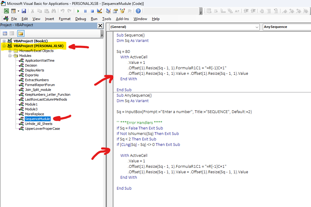

    Here are two other codes you may try.

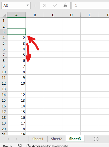

    CODE 1
    The code will create a 1 to 80 sequence from any selected cell (the active cell) downwards.
    If you want to change the sequence, feel free to change/replace the value for the variable (Sq = 80) in the code.
    Sub Sequence()
    Dim Sq As Variant
    Sq = 80
    With ActiveCell
            .Value = 1
            .Offset(1).Resize(Sq - 1, 1).FormulaR1C1 = "=R[-1]C+1"
            .Offset(1).Resize(Sq - 1, 1).Value = .Offset(1).Resize(Sq - 1, 1).Value
    End With
    End Sub

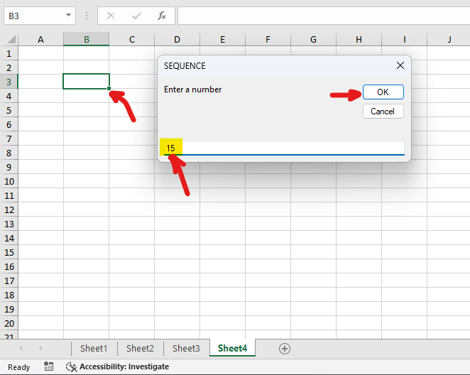

    CODE 2
    This code is similar, but it will first, ask the user to enter the number the Sequence should end.

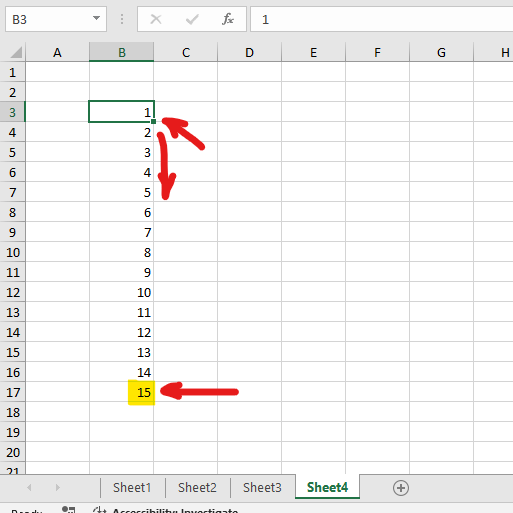

    RESULT
    SUGGESTION
    If you choose to save the code(s) in your PERSONAL.XLSB VBA project/workbook/file.
    Then, you'll be able to run the macros on any Excel file, at your convenience.
