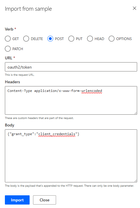

I believe my #1 above is the closest I've gotten to the correct solution. Here are a few screenshots of the set up and the resulting request/response of testing a GetToken action:
Security Settings:
My GetToken Action:
My Policy to override the Authorization header:
The tested GetToken request:
The tested GetToken response:
Here is the full text of the Response body:
{ "error_uri": "https://tools.ietf.org/html/rfc6749#section-5.2", "error": "invalid_request", "error_description": "The request is missing a required parameter, includes an unsupported parameter value (other than grant type), repeats a parameter, includes multiple credentials, utilizes more than one mechanism for authenticating the client, or is otherwise malformed." }
