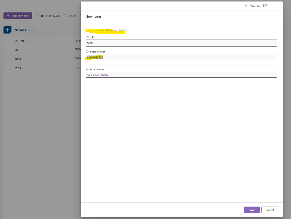

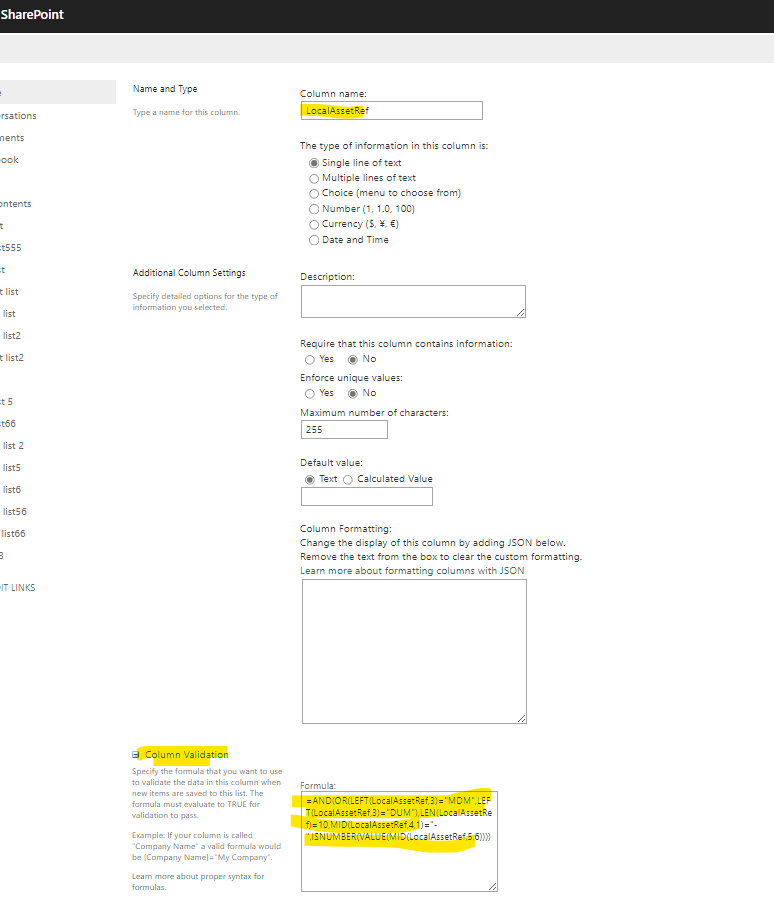

As per your description, here is other way: I tried below formula in validation to a column "LocalAssetRef".
=AND(OR(LEFT(LocalAssetRef,3)="MDM",LEFT(LocalAssetRef,3)="DUM"),LEN(LocalAssetRef)=10,MID(LocalAssetRef,4,1)="-",ISNUMBER(VALUE(MID(LocalAssetRef,5,6))))
