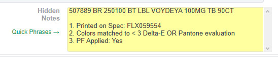

One of the fields I am exporting is entered in the 3rd party application by users as shown below. The application has no facility for entering numbered lists, so this is entered as straight text...
... even though the user enters this a straight text, the application seems to automatically add HTML tags to it. When I export the data from this field, I get the following....

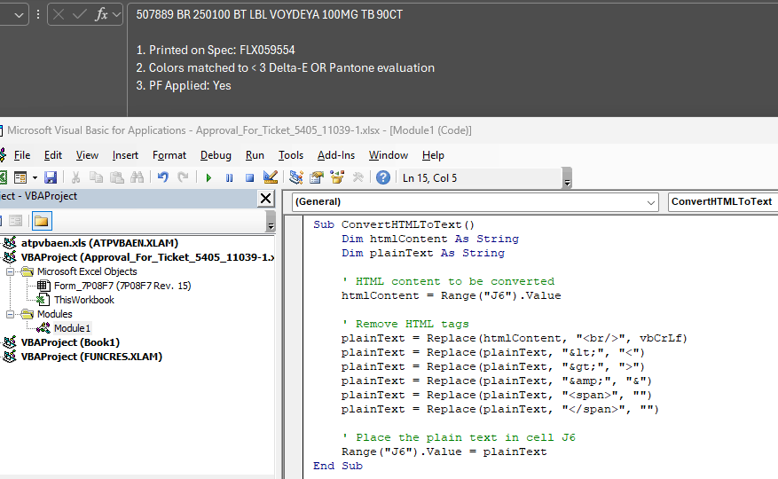

    Try macro
    Sub ConvertHTMLToText()
    Dim htmlContent As String
    Dim plainText As String
    ' HTML content to be converted
    htmlContent = Range("J6").Value
    ' Remove HTML tags
    plainText = Replace(htmlContent, "", vbCrLf)
    plainText = Replace(plainText, "<", "<")
    plainText = Replace(plainText, ">", ">")
    plainText = Replace(plainText, "&", "&")
    plainText = Replace(plainText, "", "")
    ' Place the plain text in cell J6
    Range("J6").Value = plainText
    End Sub

    Thank you Snow ! That worked great for me !
    I appreciate your help!
