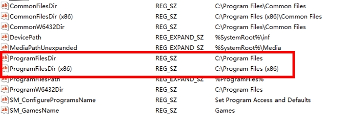

    Also refer to the following steps to navigate to HKEY_LOCAL_MACHINE\SOFTWARE\Microsoft\Windows\CurrentVersion in the Registry Editor and check if the Office data path location has been changed. If there is, please change it back to the correct path, the following is the correct path in the registry:
