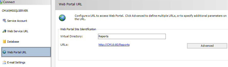

    So we could ensure if these URLs shown in the screenshot connect normally.
