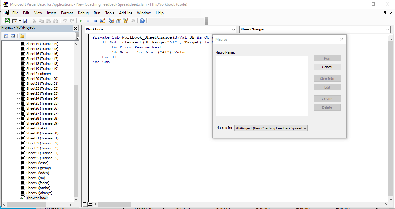

    Thanks Hans. I am still running into some issues with the code. I've followed your instructions, and I get this error:
    It won't let me run the code.

  3. HansV 462.4K Reputation points MVP Volunteer Moderator
    2025-01-07T15:28:24+00:00
    The Workbook_SheetChange procedure is not a macro that you can run.
    It is a so-called event procedure that will run fully automatically when you enter or edit a value in cell A1 on any of the worksheets.
    Try it: select any sheet, and enter a name in cell A1 (it should not coincide with any of the existing sheet names).
    After pressing Tab or Enter, you should see the sheet name changing automatically.
