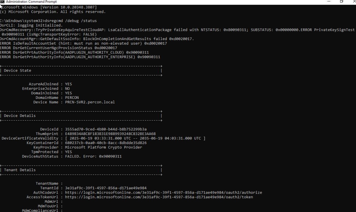

Hey Microsoft community,
I'm having an issue where we have a Hybrid environment between Azure AD/Entra and a local Active Directory VM with Server 2022 installed. We had configured a server to join connect to Azure AD using Azure AD connect so it can intertwine users' domain logins with their 365 accounts, including Office and OneDrive. We had it initially setup so whenever a user logs in to a domain-joined PC, it will automatically populate their email address into Office apps and OneDrive.
However, the server is a VM and was initially created as a Hyper-V VM. It has since moved over to a Scale computing system. Since then, devices that are joining to the domain are no longer signing into or populating the user's email address into Office apps like OneDrive and Outlook/Excel/Word, etc.
I checked "dsregcmd /status" and it is indicating YES to AzureADJoined. However, below under Device Details, I see the following error:
DeviceAuthStatus : FAILED. Error: 0x90090311
I am wondering if this is because the TPM is missing/removed from the VM now and if the server is no longer able to authenticate properly with Azure because of this.

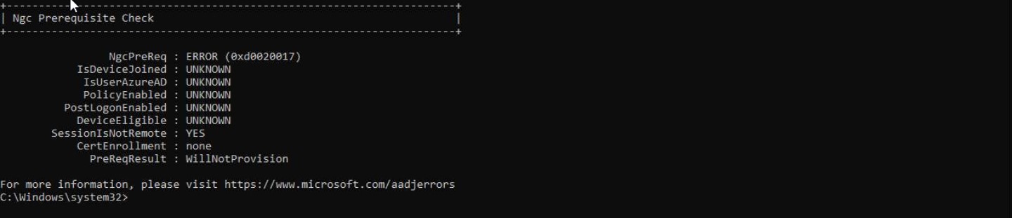

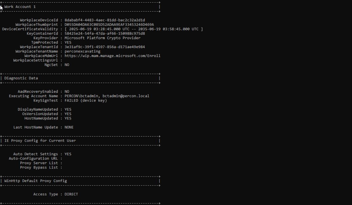

    2025-06-19T03:30:24+00:00
    Hi Daniel, thank you for getting back to me. I can tell you that I was able to convert the VM from BIOS to UEFI and got a virtual TPM installed now and that is working. However, I am still getting that same DeviceAuthStatus failed even after unjoining (leave) and rejoining AzureAD and reapplying the credentials. I also tried a /forcerecovery and re-signed in with the admin credentials in 365 to join devices, but still getting the same DeviceAuthStatus failed error. Also, devices connected and joined to the domain are still no longer populating with the user's email.
    I also configured that GPO for Automatic Device Registration and it still didn't work.
    Where's what it reads after the dsregcmd /debug /status:
