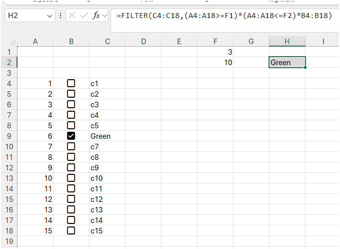

    How about this?
3 additional answers

    2025-04-05T06:59:32+00:00
    If my company always used the first Sunday, this would work. The problem is that they don't depending on when the pay period ends, and if they want to extend when people can use their PTO before they transfer anything over the limit to our Long Term Leave. For 2024, the cut-off date was 1/19/25, which was the 3rd Sunday of the month.
    Maybe what I am trying to do is a little too complicated for the spreadsheet. I created a very basic spreadsheet to help explain better what I'm trying to do. It might be that I need more than one formula.
    Looking at the spreadsheet below, column A has numbers from 1-15, column B has checkboxes, and column C has colors. What I would like to do is have the spreadsheet look at a range (for this spreadsheet, look in column A if the cell has a value from 3 to 10) and see if the checkbox in column B is checked. So basically, if cell in column A >= 3 and <=10, check if cell in column B = TRUE. If it finds a cell in column B that the value is TRUE in the column A cell range, then go to column C and return the value in column C to cell H2. So in the spreadsheet below, it would've looked at cells A6-A13, found a value of TRUE for cell B9, and then put the value in cell C9 ("Green") into cell H2.
    Like I said, maybe this is too complicated for the spreadsheet, but thought I'd try.
    2025-04-05T14:17:07+00:00
    Yes! This will work great. Thank you! I never knew how to use the "filter" formula before, so I can see this coming in handy. Thank you!!
